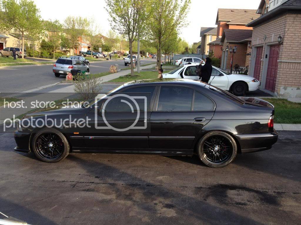

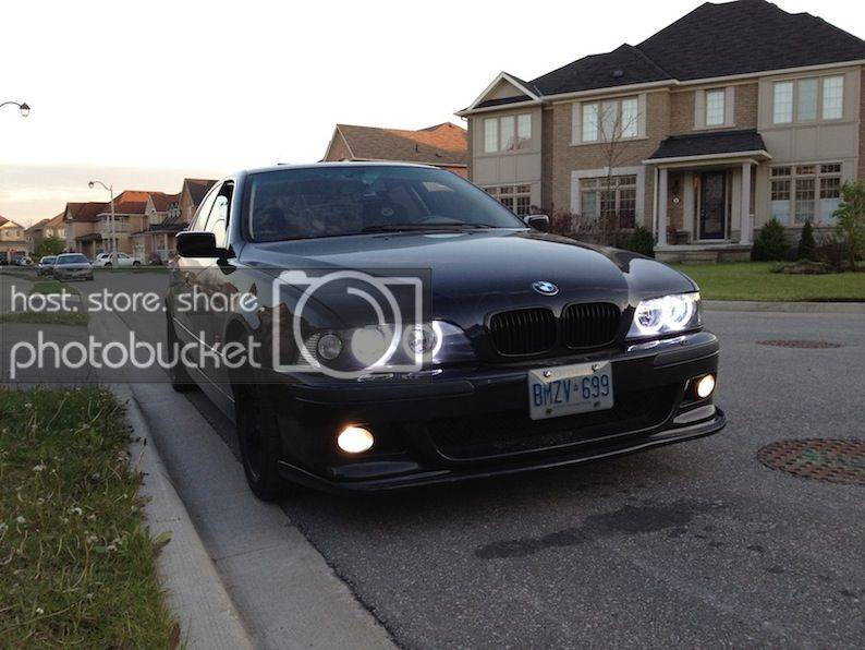

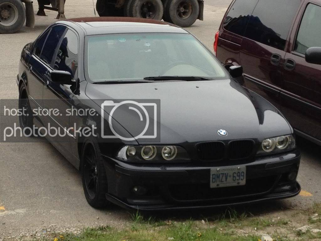

pics of the e39 please
dont mind the m badge on the side its from the previous owners original side moldings, until i find a new pair of chromeless ones

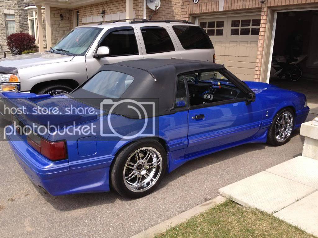

and just for fun
Nice E39 man....She's shinny //content.invisioncic.com/y282845/emoticons/smile.gif.1ebc41e1811405b213edfc4622c41e27.gif
U should swap out those orange side markers to clears to match the rest of the clears on ur ride....

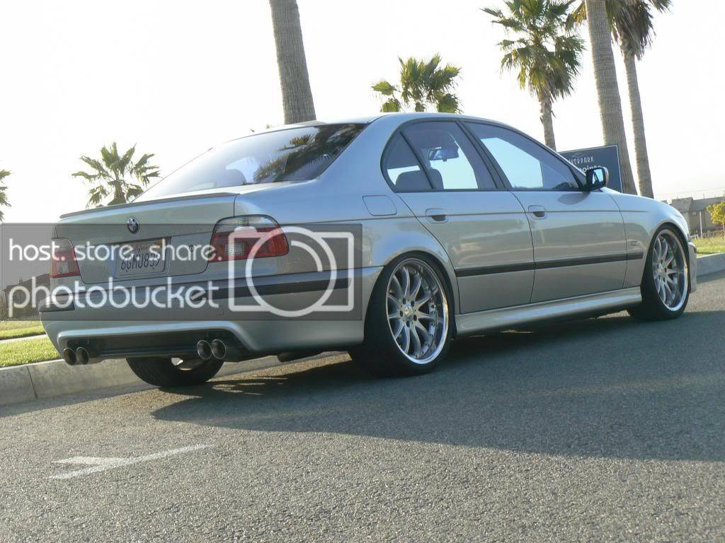

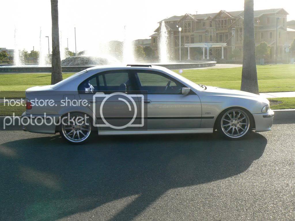

I have an E39 in my stable as well.... I just put in the All Aluminum Zionsville Radiator and electric fan mod in mine in anticipation of an ESS Supercharger.
Here's my E39 540i/6
thanks man....ur on bimmerforums right or m5board cant remember but ur name is familiar
i have smoke ones sitting in my room along with new lower grill, spacers, some dinan stuff and other goodies just waiting for better weather and less laziness
thats a nice stance love those shoes...i wish i could afford forced induction but im more of an audioholic
custom exhaust with some deletes? or do you have cans....looks awesome, something im planning aswell just working on what to do about spare tire
