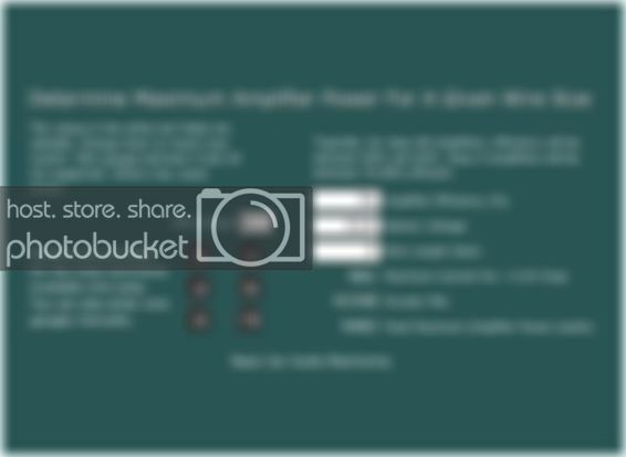

Does this appear accurate?
That chart is only calculating voltage drop. The over-riding factor is current. Regardless of how short your 4 ga is it is only intended for 125A.
Zapco recommends a 175A fuse at the amp, so you need at least 2 ga wire.
