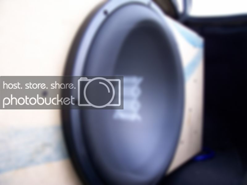

I have a few XXX subs laying around. One of my fav subs to date!!! Would take 2.5-3k daily if you knew what u were doin and for burps, the skies the limit on power. I burped one of mine with a SS XXX6500D @ 17 volts in a 4.0 box @ 30 hz and busted a 148.5 at the dash in a durango.

BTW- AFAIK, I'm the only person that had XXX's with black powder coated baskets //content.invisioncic.com/y282845/emoticons/smile.gif.1ebc41e1811405b213edfc4622c41e27.gif
