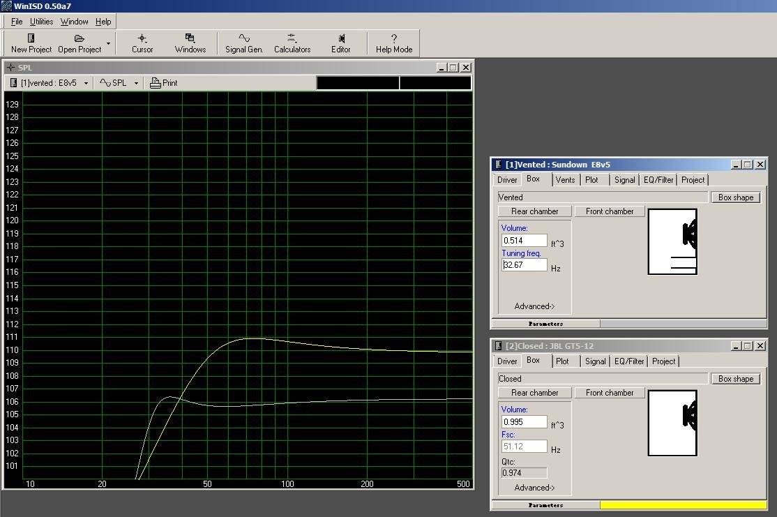

I modeled the Sundown E8 v5 dual 2 ohm subwoofer and a JBL GT5-12 in WinISD Pro.
The yellow curve is for a JBL GT5-12 in a 1 cu ft sealed enclosure on 300W. The white curve is for a Sundown E8 v5 in a 0.5 cu ft ported enclosure tuned to 32 Hz on 300W. In my opinion there is no scenario in which I would choose the E8 v5 if you also have space for a 1 cubic foot enclosure for a 12" subwoofer. That is even with the understanding that WinISD Pro does not take into account the acoustics of your vehicle. The Technical Data sheet included with the JBL subwoofer shows In-Car predicted response, and it shows a very agreeable response curve for both fun strong bass as well as good sound quality.
