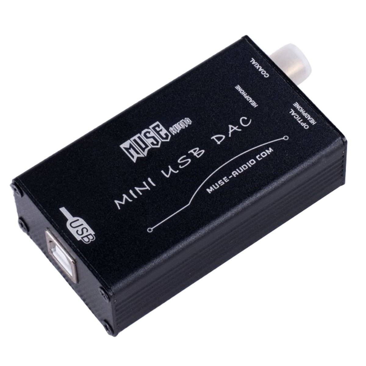

For whatever reason it wont let me post the direct link but just google :MUSE USB DAC PCM2704:

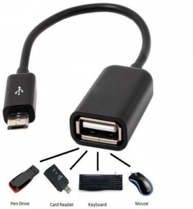

Thats the adapter but you need an adapter before that. its called a OTG cable. It lets your android act as a host. its like 5$

android phone to
then this
which goes to this
and converts it to a SPDIF signal which you use a simple coaxial cable to the CDSP

alright so now for the dac situation
so I go micro usb to usb 2.0
http://www.amazon.com/Adapter-Samusung-Android-Windows-Function/dp/B00LN3LQKQ?ie=UTF8&psc=1&redirect=true&ref_=ox_sc_act_title_2&smid=AKXVBT49GGF3B
then 2.0 to usb B
http://www.amazon.com/Cable-Matters-Hi-Speed-Printer-Scanner/dp/B00UNZ9HLU?ie=UTF8&psc=1&redirect=true&ref_=ox_sc_act_title_1&smid=A1AMUYYA3CT6HJ
and then into the dac
http://www.amazon.com/USB-DAC-PCM2704-Optical-Converter/dp/B0093KZTEA?ie=UTF8&psc=1&redirect=true&ref_=ox_sc_act_title_5&smid=A2NG2OQRK6L38B
and then the coaxial to the CDSP

Yes. Now just so you know. I havnt actually done any what im recommending. I will in the near future and im telling you to get what I was told to get from the cdsp thread.
I understand if this dac doesn't end up working I won't put it on you I'm doing a little more research quickly if it doesn't it wont be a big deal I can use and aux cord into the cdsp until I did find one
The cdsp doesnt have an aux input and the aux on the dac is an output.
There is no reason it shouldn't work though. So I wouldnt worry.
