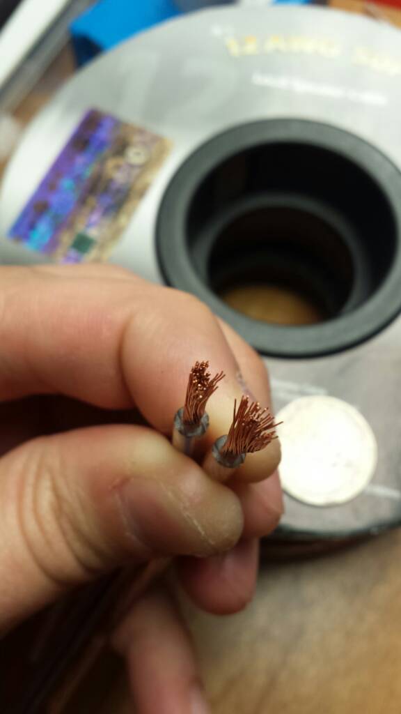

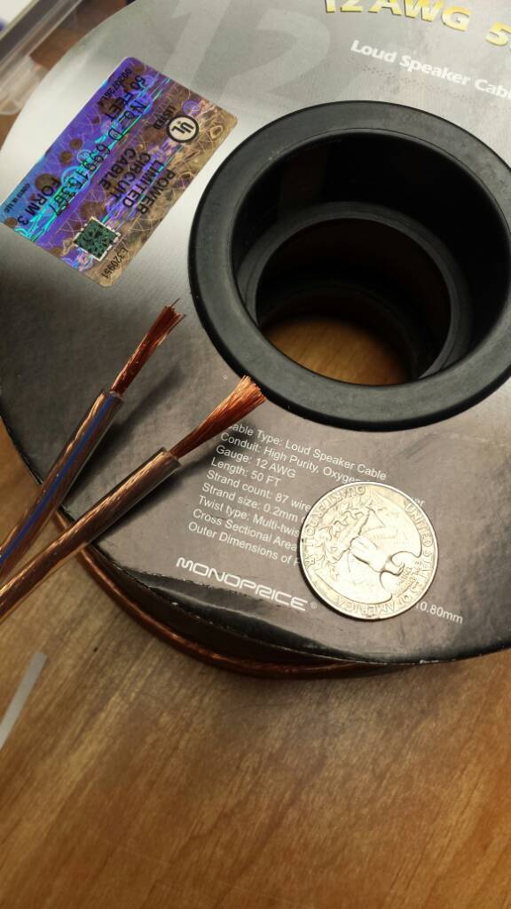

I don't know how it compares to other brands, but I used that for my dad's stereo (going atleast 40ft). Sounds good to me and he's loving it. I actually have some on hand, though I don't know what you can glean from these pics

thanks for the picture, it defiantly looks like good cable. looks just about as thick as some 12g sky high cable I have the sky high has a little advantage but at about double the price.
