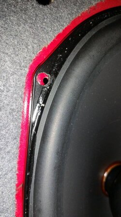

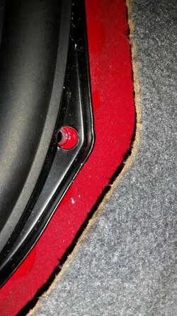

I made an adapter out of 1/2 wood that I had laying around. It seems as the holes for the speaker and the holes for the rear deck are too close together making the screws hit each other.
Should I use 3/4" or 1" MDF and some smaller screws?
Fabbed up some new rings with thicker 1" MDF. Test fitted them and everything fits perfectly. Also picked up some smaller screws. Gonna pre drill the underside mounting holes right now, already got the top done.
I like how the adapters are thick enough to wrap LED strips around. Its going to look awesome. This if my first time doing something like this.
