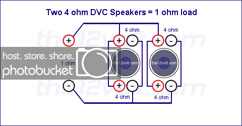

It's wired like so... Wiring Diagram
I'm still looking for a suitable mono amp for it. I have a price range about 150-250$. What is it I'm looking for when Amp specs mention 1500W @ 2Ohms and 800watt @ 4ohms. I know the wiring I have is for a 4ohm load but prices seem rediculous for a amp that can handle what i need. Someone shoot some links or ideas?
Wire them to 1 ohm, dude. There are tons of affordable amps that do 1,200 - 1,500 watts rms @ 1 ohm.
