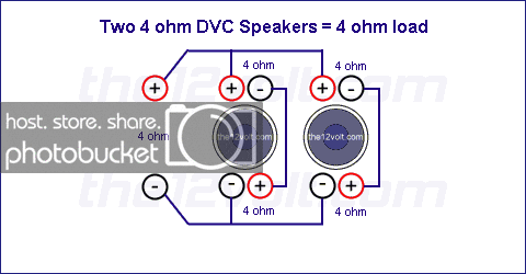

Why a 4 ohm final? Just asking why that'd be better over a more powerful 2ohm final
You can't do 2 ohm final. With 4 ohm DVC subs, you can do either 1 ohm or 4 ohm. Your amps can only run at 4 ohms in bridged mode, so that's your only option. If you plan on getting an amp in the future, come here before acquiring new items. You don't want to have to deal with mismatched impedance and lack of power again.

Final on each channel is two ohm? Or should I have them bridged?

That is what he is telling you. parallel the voice coils(2 ohms each sub), then series the subs(4 ohms total), or series the voice coils(8 ohms each sub), then parallel the subs to get 4 ohms, bridge the Sony amp (that's left+/right-).... it will give you about 500 rms into one 4 ohm channel then.

take both the red & white sub output rca's and run them to the sony amp. set the switch to LP and set the LP filter around 80 hz. Use left+ terminal and right - terminal to hook up to the subs. Wire your subs just like this diagram ....
