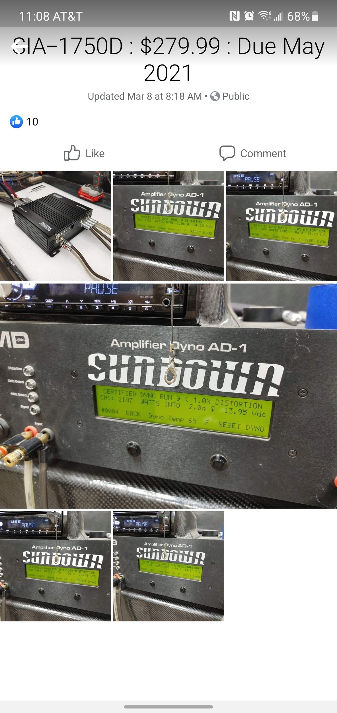

According to what I have read I thought the sia-1750 did the same at one and 2 ohm.
