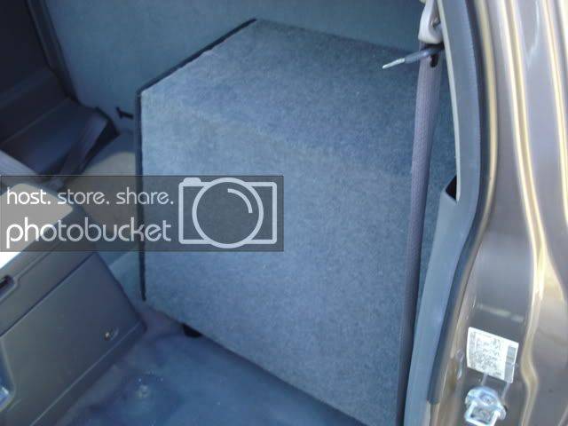

I've been into this car audio thing for 20 years, so I've seen a thing or two. I recently purchased a ranger extended cab pickup and put a modest system in it. For a sub I'm running a DD 512b in a pre-fab (I know, I know) box that is 1.7 cu ft and tuned to 33hz according to the manufacturer. The sub is brand new and only has bout an hour or play time on it. The sub amp is an Alpine MRV-M500, so around 500 RMS at 2 ohms.
My issue is there seems to be plenty of mid to upper bass, but not so much low end. The sub isn't flopping around and doesn't seem to be unloading. Putting the windows down seems to help a bit.
Is this a function of the extended cab, or should I be looking at my box, or are the DD512b's known to do this? I've played around with x-over points (Alpine does not have a subsonic) and EQ settings on HU. I am considering both sealing up the port and getting an epicenter, think that would help?
Have you tried firing the port into the corner? Experiment with rotating the box around and see how much difference that makes? Perhaps you just have unreasonable expectations out of small entry level sub in a small box?
I want the box to stay where it is, works real well for packaging. Maybe your right, but I'm coming from a sedan with a Kicker L7 8" in a small sealed box (same amp) and remember it hitting the lows better.
Eh, I'm an old man now, I don't need crazy bass anyway, I can live with it. Probably just try sealing up the port and see how that goes, if no change then F it.

There really isn't the room to do so, the side with the wiring is very close to the extended cab door panel. The whole box cant be scooted over either, the jack assembly is in the way. I don't want to fire it up as I will toss stuff on top every now and then, and don't want to fire it down as the 4-channel amp lives there. It would be easier to make a little wall for the port to load off.

that box looks really small for 1.71 what are the measurements of it? by looking at it I'm guessing 18Wx14Hx16D? it looks like the boxes they sell here in downtown LA and they are tuned really high.
I think you guys are right, box is too small. Shame on them for lying, shame on me for not knowing better. Here is the actual Amazon description from when I bought it:
I've only messed with ported a few times. What would happen if I increased the volume of this box while leaving the port length where it is?
well technically they didn't lie, they just used your ignorance (no offense) to sell a box. it is around 1.70^3 BUT thats gross volume. the actual volume the sub sees after all displacements is probably 1.38^3 or somewhere around there. it is tuned to 33 hz though if the slots measurements are 1.5x12x24.25?
Seems my post didn't stick, but I went out with a tape and did some measuring. After subtracting wood and volume, you are correct it should be around 1.39cuft. I threw that and the port measurements in the calculator, and even if I'm a few inches off it checks out at 30-35hz.
