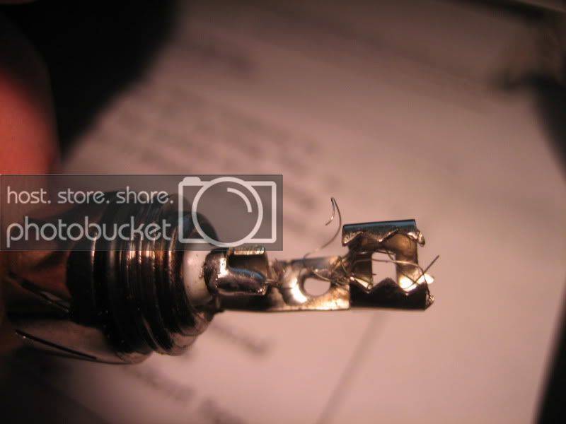

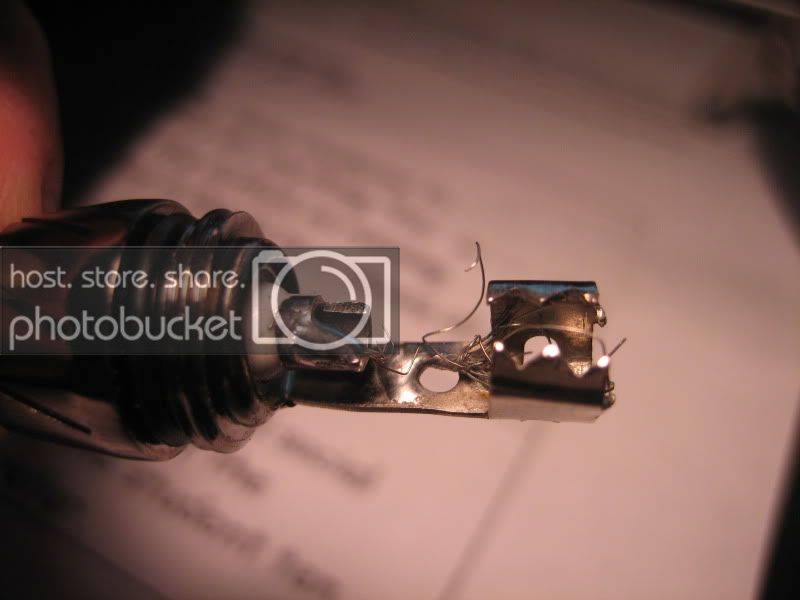

So it came apart, do i resolder the wire to the middle point. I suppose the outter portion is just a support post.

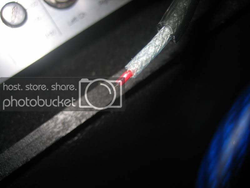

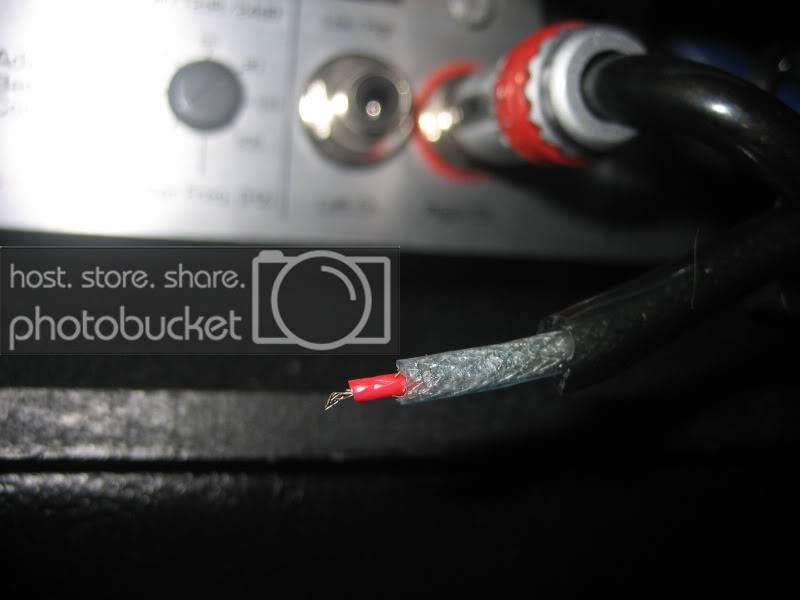

let me guess kun rca right. there should be a colored wire inside the warped by other wire . solder the colored wire to the middle post and the other to the out side post wrap it in electrical tape . make shure you have the screw on piece on first or you will have to un solder it and re do it
its kunconceps wiring if you happen to pull just a little to hard on the wire and not the connector it breaks at the solder point
If they would have those Chinese prisoners crimp the d@mn ground tight that wouldnt happen.
thanks guys!
it is a Knu RCA, funny how you guys know that heh.
So I will resolder it to the short stubby post and then wrap it in electrical tape?
