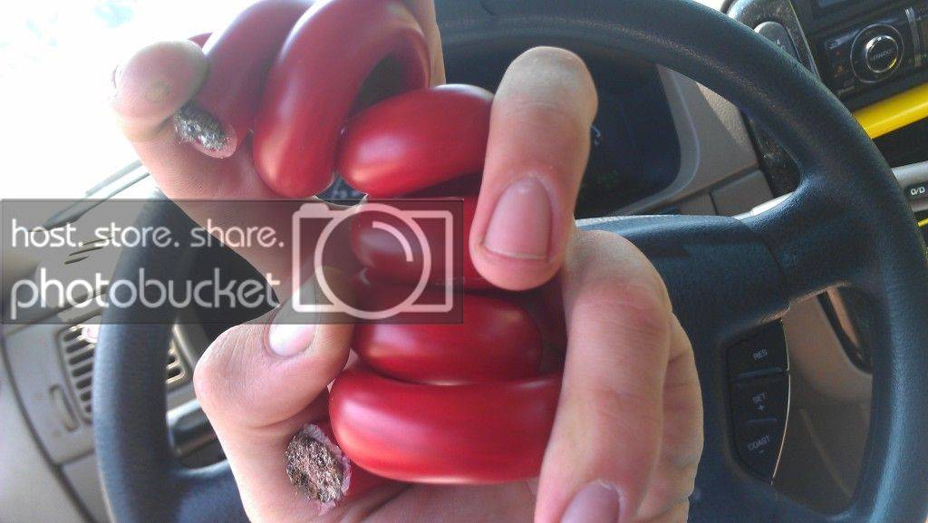

ive personally dealt with knu and AT (and also the flaky stuff) knu and AT are very flexible AT maybe a little more, knu does have more strands, i tried explaining this to someone earlier i ending up going with knu bc its more strands AND if you need to be wire more than the KNU will bend it shouldnt be in a car lol,
thats KNU kolossus fleks 0 gauge..
