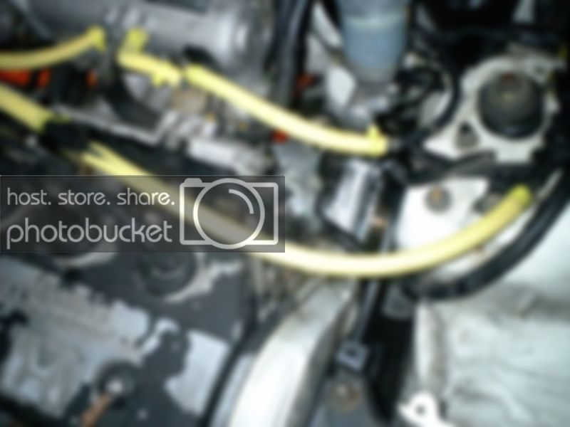

if you want to cheap out get a alt off a suburban, large case gm alts work with a very small amount of modification
See this is interesting, I have a full-size GM 260 amp from Iraggi I originally bought for my S10 Blazer. It looks awfully big to fit though, plus I assume the plugs are totally different...? I was assuming I was gonna need a stock sized case since its so small to begin, and not alot of room around it. Maybe I need to look closer.
Thanks for the info on Powermaster and Mechman, two options I hadn't thought of yet.
my large case GM worked, but it was externally regulated.....
and yes it is very large and not fun to fit in there, but it can be done lol
You have to make the top bracket a bit longer and you have to put a few washers on the bottom since the bottom bracket for the large case alt is about 1/4" smaller than the honda one
Wow thanks alot for the info and pics man. I see how you mounted it, clean. Mine isn't externally regulated, but I do have a module that makes it a 2-wire, so I may be able to make it work anyway.
