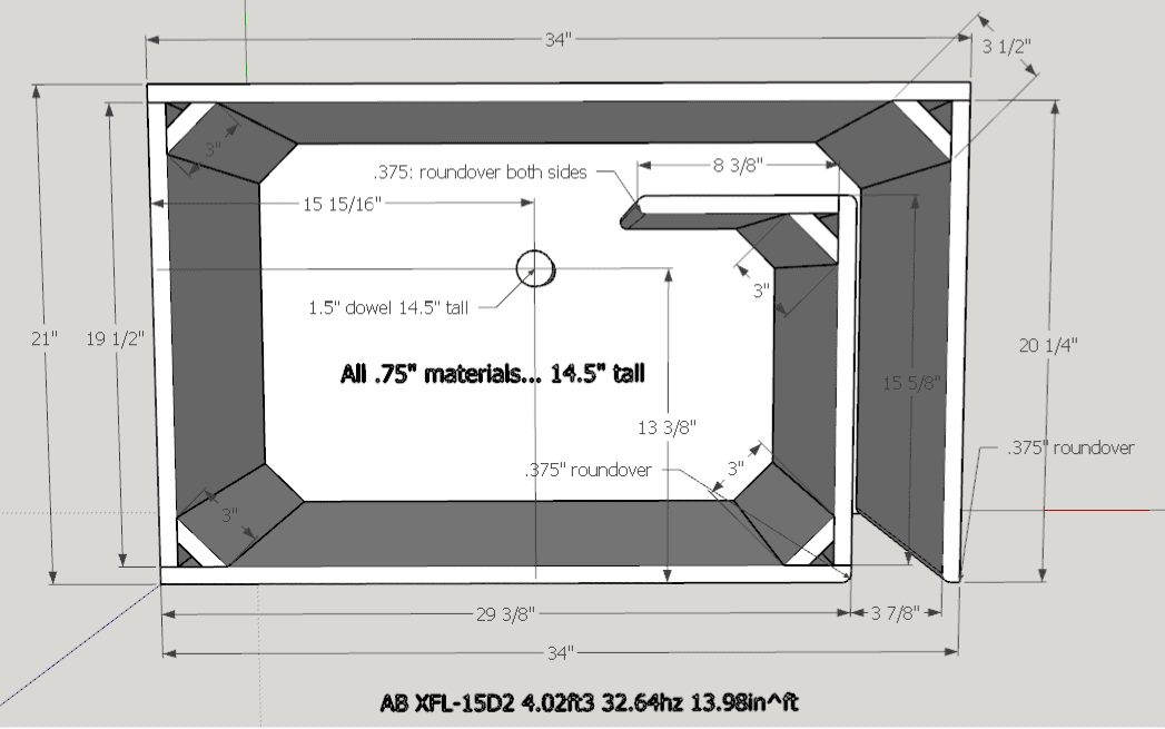

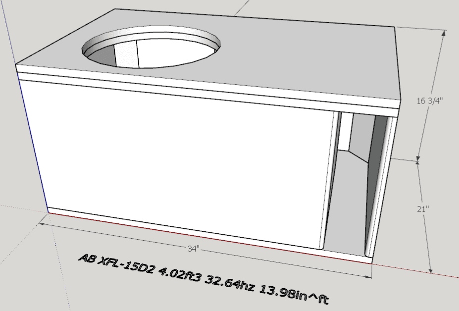

Thats Awesome of you to share your knowledge, and time! Any view of the lid off and measurements stamped of the port length??
Interested in those particular plans?.. PM me and ill see what I can do. You lookin' at the same area available or would you like it sized/configured differently?.. that's for rated plus some above btw.
Im not actually. but i see you post lots of plans, but not the port length for tuning.. tbh, ive come up with a couple different plans for myself. just not sure what will work best, or if the different port orientation will even matter
If your interested, both boxes are 5.5cu ft tuned to 31hz after displacement (double baffle not shown) of 3 SA12s. running on a scv3k @.6 ohm.
https://imgur.com/a/LMAkFCS
The thing is, the rear hatch is about 16" from port. So is one box design better at handling it loading issue than the other?
same port area and displacement
Sorry about the wait... had to dimension the thing... lol... I'm not too sure on how much you'll gain from loading it at 16" from the hatch. Or what type of enclosure/port will work well at that distance . I always try to keep the clearance no less than a port width away... that's all. Unless it sits in the center of the cabin, I don't worry about it. Others have hard won experience learning what works and what will disappoint. I don't know what goals you are tryin, for... semi-decaf tuned, with grocery space?
Anyways... here it is as requested...
