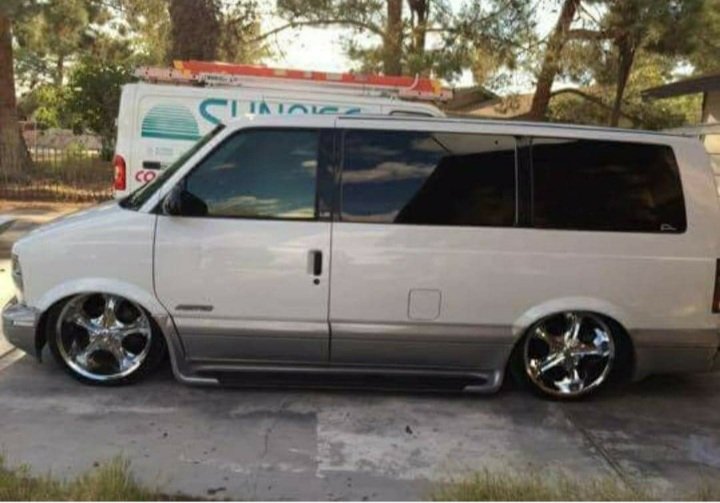

I've gone as far with the electrical on my Vue as I'm gonna go...i got a smart 3 in it now but if thats the cap then thats the cap...I'm hunting for a 1st Gen astro so I can do a real build without so many space restraints...beside I think they look cool 😂
