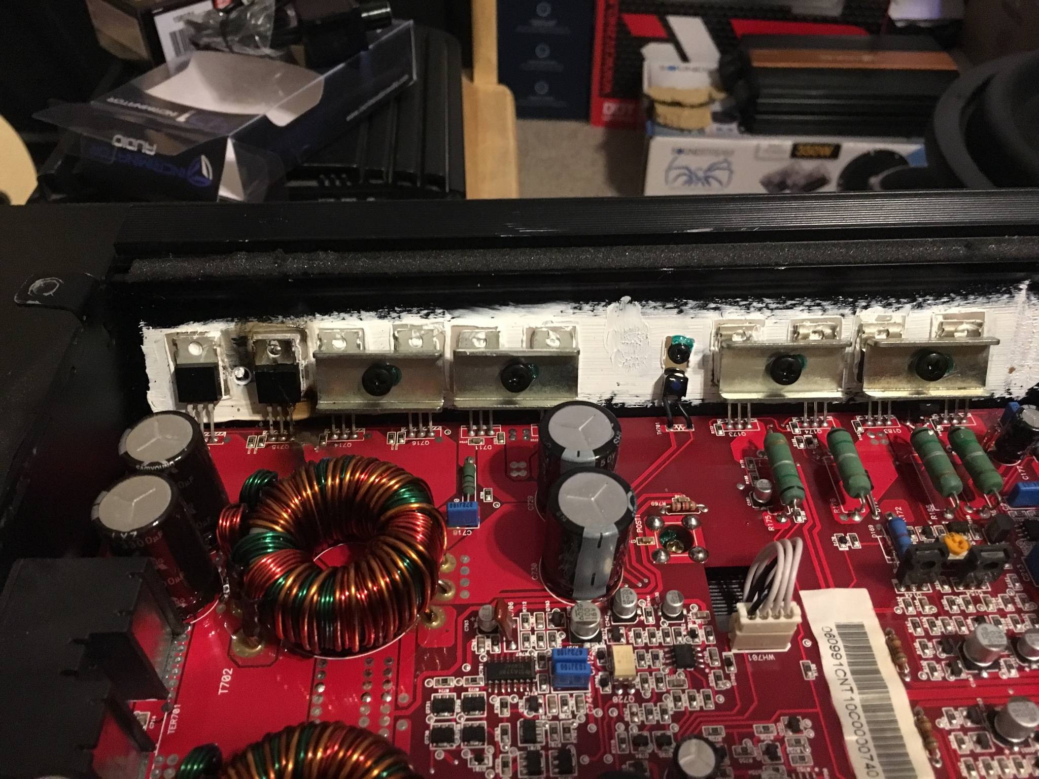

I don't know what these are called Ik it's for the heat but the actual name. It's an Orion xtr 500.2

Yeah that's mine, and in the trunk of a charger it gets real hot, it was used got 2 amps for 35$ was working fine until I put bigger wattage subs in.
well that amps gone so now let just be for sure what subs and ohm load they are and find an amp that'll work for u

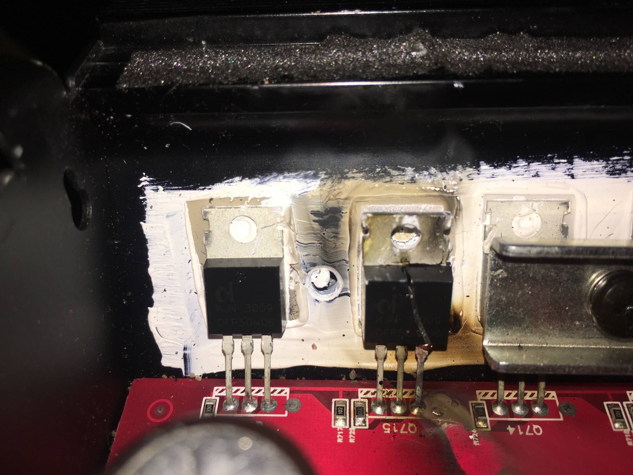

If you have patience and a fairly steady hand..you can solder a new Fet in place and more than likely be up and running again..Board looks fine..Run it ona pair of 6.5s tweets,or 6x9s.It may be salvalgable
you do instill confidence and hope! But i cant disagree with you at all. I should send you some guts pics of my PPI PC2200 so you can maybe point such a simple solution out for me. Im gutted to think that its relegated to an expensive repair considering they sell for so cheap everywhere i see them or a paperweight like it currently is
Implying that the only bad one is the obviously burnt one. Implying that you won't need to replace all of them to match if you want the amp to work, and also implying that something else didn't get taken out that isn't visibly burnt.
Not saying there isn't an off chance it would work but the guys who repair amps professionally don't charge what they do because you can just replace obviously broken parts and call that a repair.
Also, OP, those are called the "smoke storage containers" and the amp will only work so long as you keep the smoke in them. Once you let the smoke out they don't work anymore.
