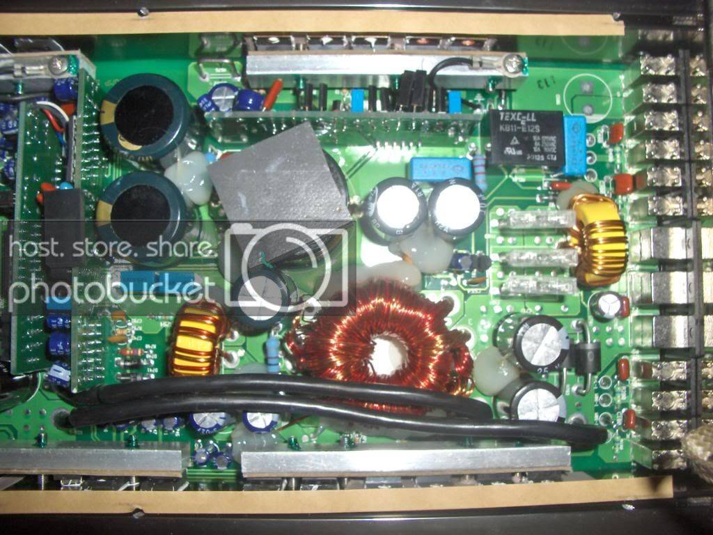

Hi, I recently bought an amp off a buddy and he said it worked but when I installed it into my car, I couldn't get any power from it. No lights came up at all. The fuses are all good. I opened it up and it looks pretty normal. Nothing looks burnt or anything.
Problem could be with my electrical or something, but I don't have a multimeter to check right now. The amp is a Memphis 16-MC600D, 5 channel amplifier.
Where are the areas I should inspect more closely?
Definitely outside of my knowledge range to give you a full run down. It looks like you may be missing a few piece of the board. It looks like it may have been repaired before as well. There looks to be some oxidation on the board and with the age of it cap replacement would be something to consider. There could be a million reasons. It really needs to be in the hands of a professional.
Where does it look like it's missing a few pieces?
Edit: Just looked again and the board (green part) looks really clean and no oxidation. I don't see any places where something could be missing either is there a way you can show me? Are there any places that will test the amp for me or look at the components inside it?
I don't think there's anything missing, I found amp guts from another website:
And here's what I think you're talking about on picture 4:
But what do you mean on picture 5?

There's so much that could be toast in an amp that you can't see just by looking. On the bright side, that's a nice classic amp there so definitely worth the cost of a repair. DO NOT cheap out when sourcing a shop to do the repair DB-R in Texas, Ampmedics in Florida, or Zed Audio in California, and Sound West in Tacoma are all competent and reliable. The guys that do solid work aren't cheap and have a rather slow turnaround. If guy can do it tomorrow it's likely he's a hack because the reputable shops usually have a stack of stuff to repair.

Sooo... This might be funny or it might not, but here it goes:
I took the amp to a local audiophile shop, literally called Audio File. They hooked the amp up to a power supply and it powers on..
They used a signal generator to make sure all the channels worked too.
So, It must have something to do with my electrical, right?
I go to my car to see what is getting power to it, and what is not. I have a bundle of wires in my trunk from old installations and its just sitting there. Turns out, last time when I hooked the amp up, I was using a remote wire from that bundle that wasn't connected to anything.
Long story short, amp works perfectly; I'm an idiot that hooked up a remote wire that had wasn't hooked up to anything.
