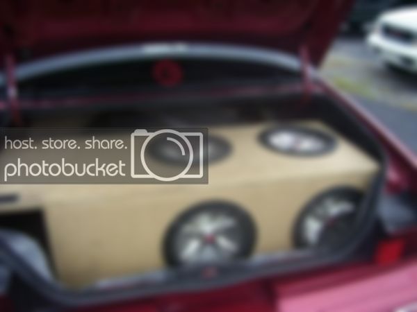

Ran off a Massive p1500.1. What would you change about the box? around 6 cubes tuned to 37 or so
Subs on top and port/s to the back would be a start. Worked well in my car, not saying it would in yours due to every car is different.
Subs don't usually work as well firing upward in a trunk application. Either facing foward or to the rear would be your best bet.
