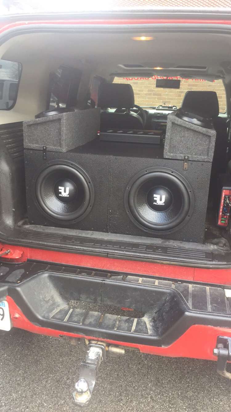

I finished my hummer h3 build about a month ago and loved it. It was insane at first, but now its too light for me and i'm ready to upgrade again.

2 12" fu audio 750's in a 4.5 cu ft box @34hz

get two more FUs and another amp?
do you think I can sustain enough power for that? Also what about space?
Just a better box sub back port back should sound louder
how would that compare to say two sq hds312 1200w rms 12's?
Sub up port back
What's with the 6x9's on the subs in their boxes? Is that the rear fill/speakers?

Id say the fu are are the same lvl as sound qubed hds3... Just a better box loading off the hatch should gain a db or two.... And or a bigger amp. Get like a 2500watt amp
i bet its not louder. the side firing and firing back does fine. Id get 2 more woofers and another amp then worry about subs up port back..
The port he has now is firing like right by his back door... It would be much better side firing all the way in the back corner of the hatch or even ported to the rear....
Just ordered 2 more FU audio 750 12's and another fsd1600. A couple of questions, do I have to strap the amps? Or can I just wire each pair of D4 subs to 1ohm and to each fsd? Will I have enough power with the 250amp alt to power that or will I need a 3rd battery? My 2nd is pretty small.
I also need help with a box design, would prefer aero port. The dimensions I have to work with are 28L 28W and 37H.
