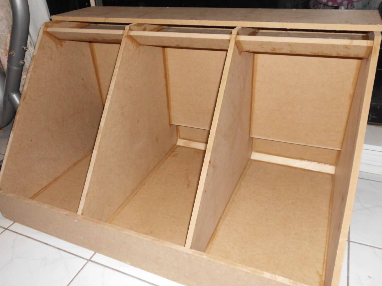

The box I built looks like this
and I designed it to have this shape in accordance to the shape of the back of the car to try and get a "horn effect" going.

dont see that design working very well...

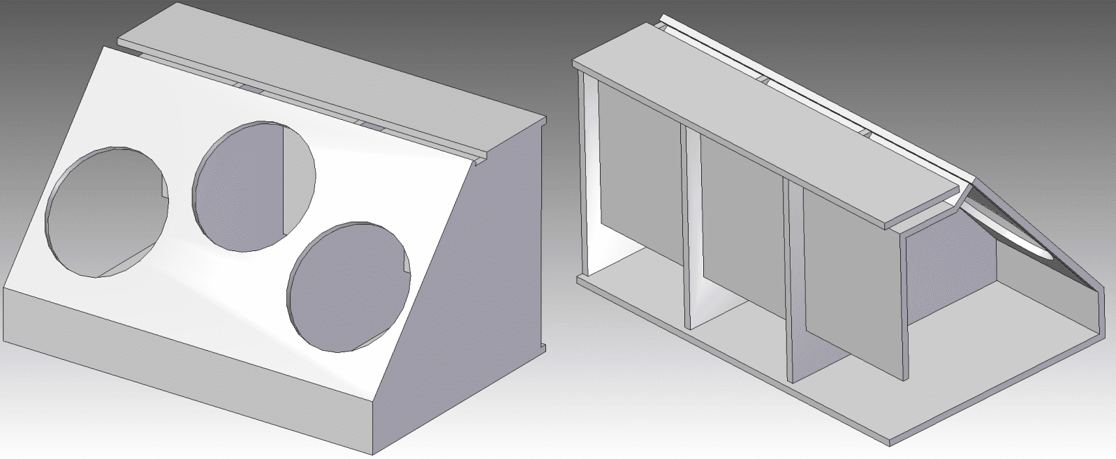

Well it's doing great so far, had it in the car close to a week, here's a better picture of what it looks like completed/modelled but I'd have to take a photo of it in the car to give a better idea.
Only been able to give it 400watts rms due to my crap battery, soon enough I'll be getting an AGM deep cycle and pushing 1000watts, I have a wet cell starter battery now, not really made for audio lol.
port is too small and the ratio of length to width should ideally be 1:1 or as close to that as possible...
yeah I talked to mobileenclosures about that, the limit for length to width is 8:1 before resonance issues occur and mine was closer to 7:1 so he said it should be fine. As for being too small the wind speed stayed under 25m/s in winisd at all frequencies when only pushing 1000watts. I think it peaked at 23m/s at 23hz.
