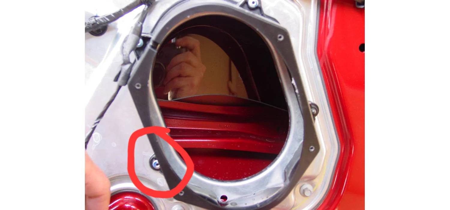

For early 2000s models Fords, what kind of fastener is this that holds in the factory mounting bracket? I have aftermarket brackets for 6.5s that will fit in there.
The fastener looks like it just has a perfect t circle on the head so I dont think Allen keys or star bits would work
It's a pop rivet.
You'll have to drill it out and replace it if you're going to pull it off for any reason.
