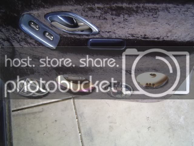

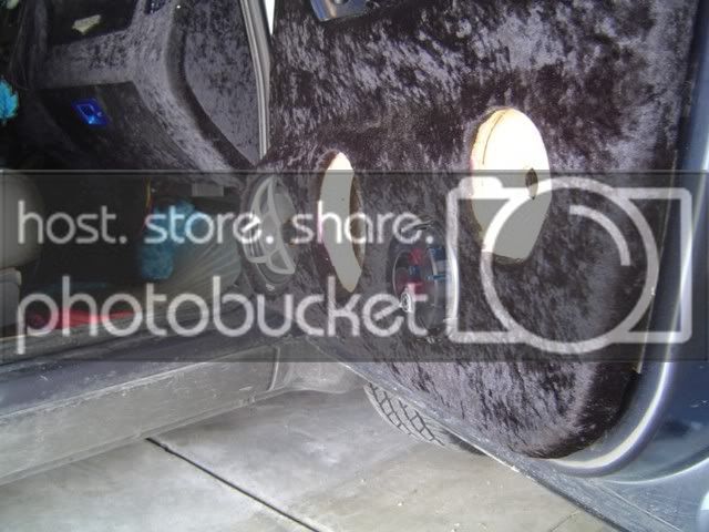

Well now...A while ago i decided I wanted to fit a 6.5" component set into each front door of mine...
Went with Kicker RS 6.5's...off of a ZX350.2
Which basically meant fabbing some new door panels...

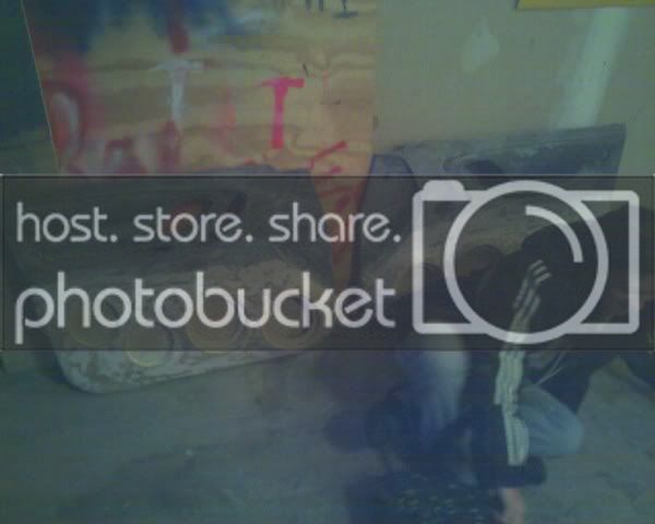

I used the existing door panel and did some cutting and ended up with this...
Wish iw ould have taken more pics but ehhhhhhh.

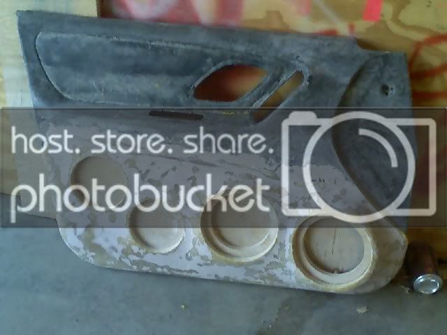

Here it is stretched out and ready for glass:
Did a few layers of glass/mat...then some bondo work...
heres a crappy cell phone pic of bondo work:
And I decided to cover it rather than paint it.

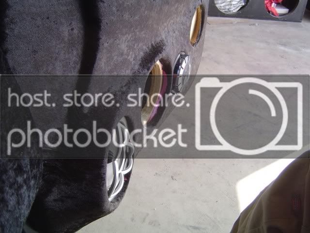

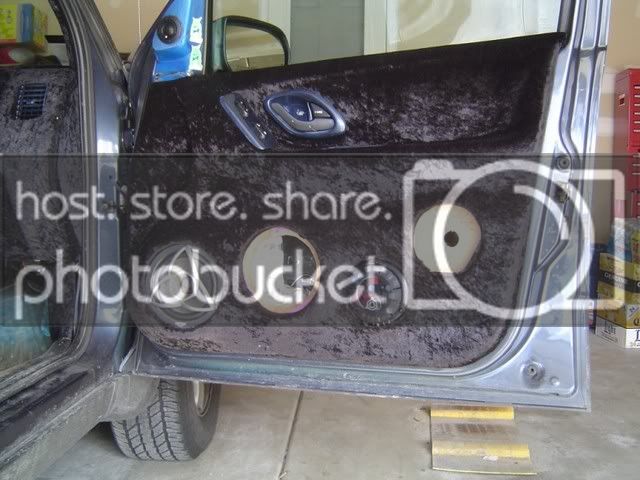

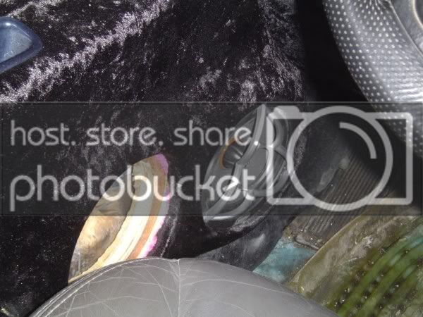

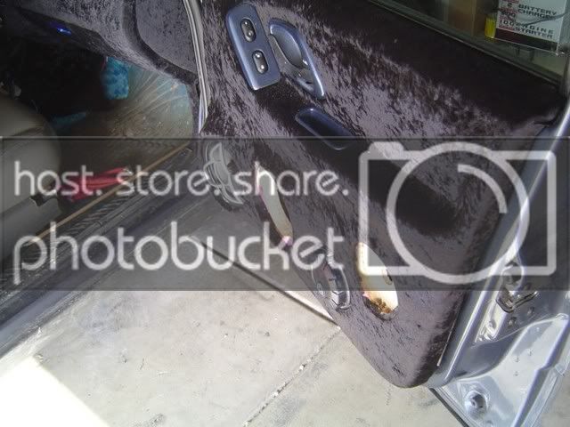

And I ended up with this:

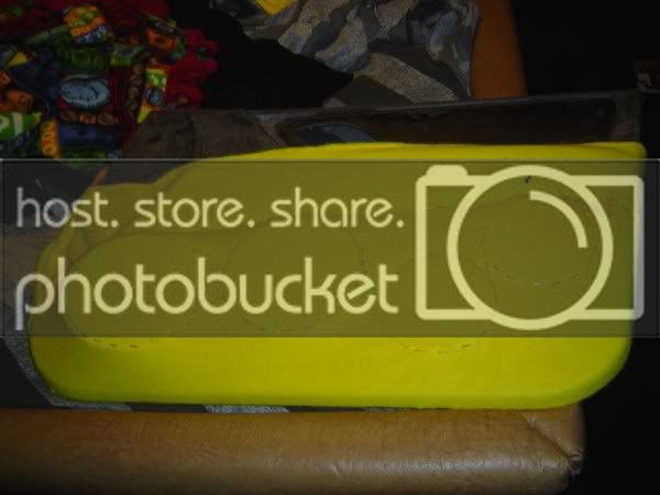

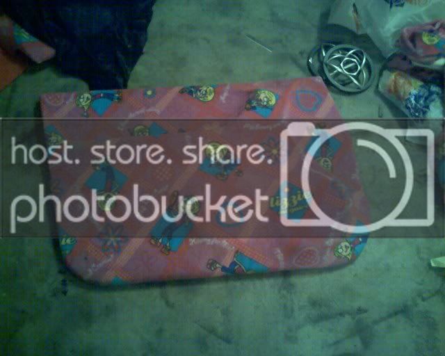

dont mind my **** fleece....I wanted to add some extra padding to the door due to my velvet material being very thin and I didnt want the hard door panel feel to it.
now I have to figuire out where I'm going to place my 2nd tweeter at..thinking about moving them to the a pillars...
2 in each a pillar...since I doubt i can fit 2 of them in each sail panel where my existing tweeters are...without some heavy modding. And I'm not sure if i'd like them in the door panels either.
