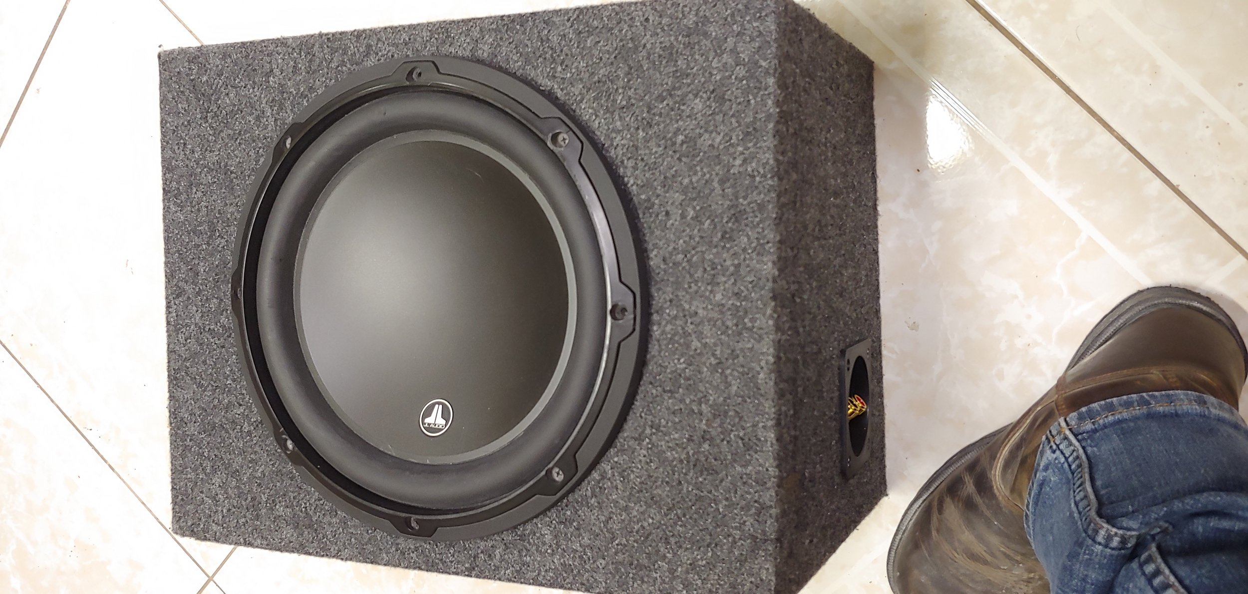

I have not listened to that particular Skar sub, but I have a JL 10w3v3 in a sealed 0.75 cu ft box and it sounds really good. Clean punchy bass that defies the the box size with the output.
Had it in an extended cab on top of the back seat firing up. I was contemplating taking out my current amp a subs combo to put it back in along with a JL XD600/1. Just thinking about it makes me giddy.
BTW, no lack of low bass notes. It goes low.
BTW, no lack of low bass notes. It goes low.View attachment 52648
