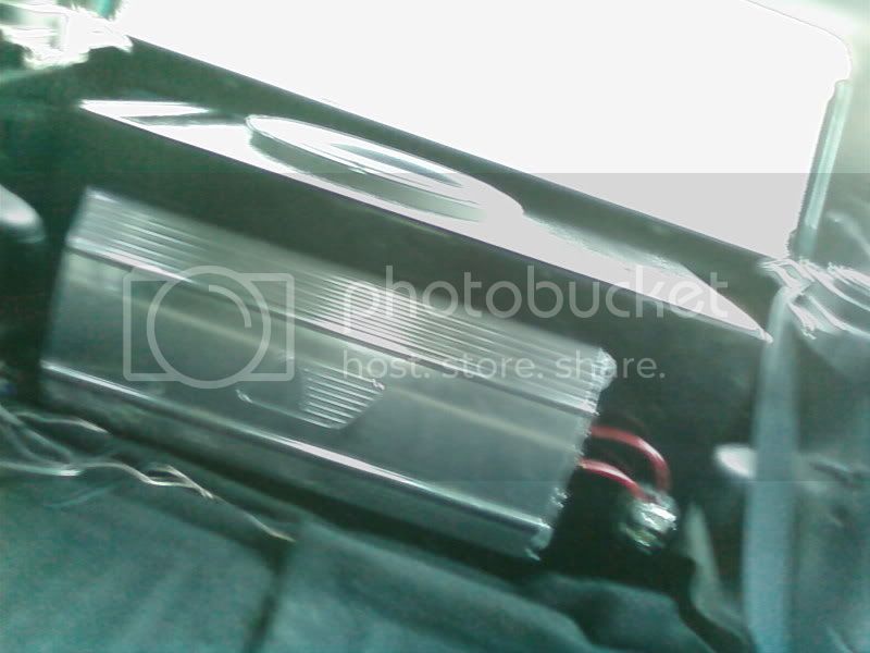

Well my amp was installed on the floor by my backseat but that put me in the spl-modified 1001-2000 instead of the stock 601-1800
So I mounted my amp on my box under rubber mounts to make the vibration less intense
Got a distro block with two 1/0 inputs and three 4 guage out and some 4 awg wire upgraded to 10awg speaker wire from 16 awg installed a bass remote that controls the gain not the bass boost and all the material besides the 1/0 is all courtesy of seth phillips from his shop. Got the wires ran for an extra battery. And I still need to install the fan for my amp
Here is a pic for today. Ill post more once i finish and the next pics will be with a Team RF 4hp 15":naughty:
Its a rats nest till i get the second battery installed
Im sure you already know, but amp mounted on subwoofer box is bad. Vibrations can shake parts loose
and why does mounting the amp on the floor change you to modified?
He should be fine. Its on rubber grommets.
yea it will be fine its on rubber
and it puts me in the modified because its not in my trunk/hatch hence modified
The amp mounted to the box is fine. I have never had an amp fail that has been mounted to a box. Not even my 2 V4000XD's mounted to a 12^3 box with 2 18's...still worked the day I pulled them out..and I didnt use rubber grommets either.
