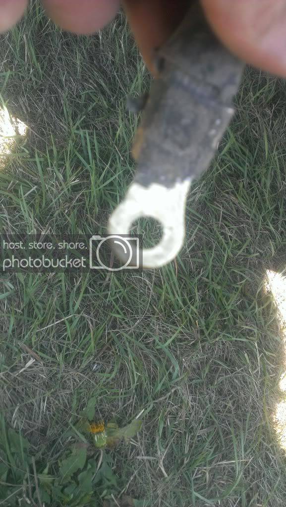

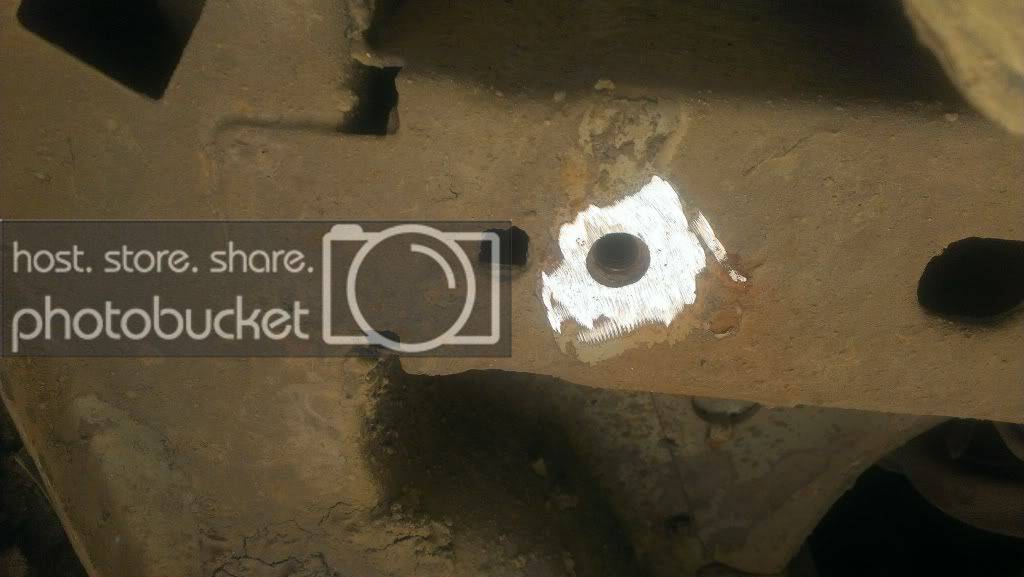

lright, I tried regrounding it but I knew it still wasn't grounds cuz if you'd touch the power and ground together it wouldn't spark. So I touched the power around a bit and found someplace that would spark. Turned out to be 2 random bolts that stick up so I just wrapped some 8 gauge around em and it works. Here's the ground that is directly to frame, grounded down.
And this is what ended up working. Not sure why.
