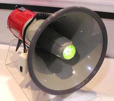

its a folded horn.
have you ever seen a trumpet?
well instead of blowing into it with your mouth, imagine a speaker there. hey, kinda like a bullhorn.
as far as car audio suboofers go, the USUAL folded horn looks something like this inside.
but for suboofers. so they are big. and i have yet to learn how they work or are made. so dont ask.
