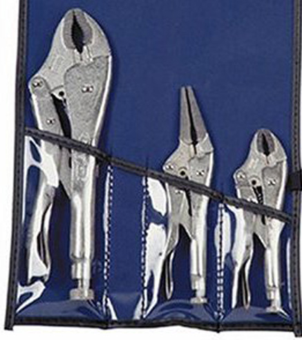

that to forgot to ask did u clap the brake hose when closing the caliper to put in the brake pads ? if not u have alot of air in there if u did then try it couple more times

that line was suppose to be clap when pushing back the cylinder from the caliper.
then when bleeding u was suppose to release the clamp and start the bleeding process

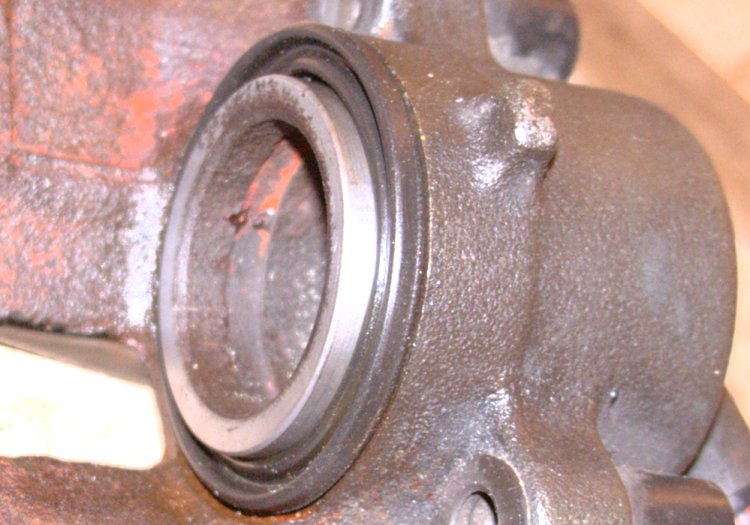

what do you mean clap? You mean...when I compressed the cylinder in the caliper I should have had the brake line attatched? Cuz I didnt...I didnt attatch the brake line back to the caliper until i had the pads back on and the whole thing set up; right before I put the tire back on...what does this mean now? Is that why its not working right? What do I do to fix this problem now?
wait so you completely removed the caliper to push back the piston in the caliper?
Yes... I took the caliper all the way off including off the rotor and off the brake line....then I compressed the cylinder; then I put it back on with pads in it; secured the thing in place; then reattacthed the brake line.
alright than you probably lost allot of fluid and and got allot of air in the lines. so best bet would be to try and bleed it a couple more times and see what happens. i mean at this point the brake fluid is the cheapest of the possibilities.

yeah should of been attach and at the same time u should of use a clamp like the one in the middle with rubber on them to not break into the hose while clamping it
