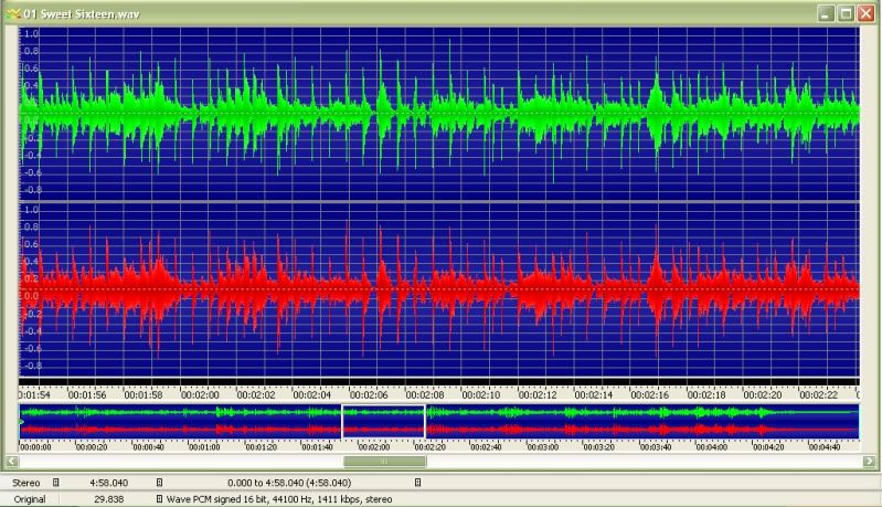

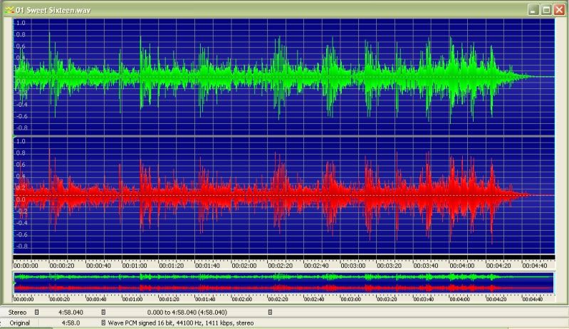

actual clipping is apparent in modern music. the sound engineers try so hard to maximize the signal they get clipping and just let it slide. i use a program called Goldwave to view audio files (voltage vs. time). i can show examples - just about anything popular in the last 10-15 years has been jacked up.
look at the post times - that is how long it took to find a song.

this is the entire track:
this is zoomed into one portion:
and a closer view:
that is clipping due to excessive signal amplification or just poor recording methods.
i used Goldwave to examine any track that i want to use for reference listening.

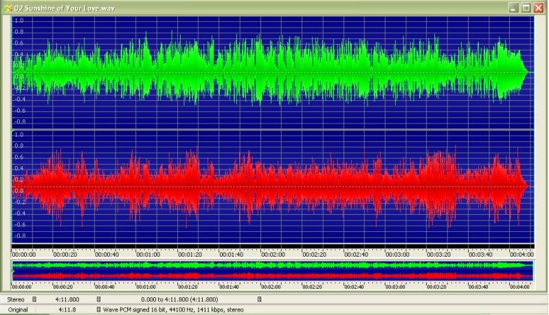

an example of what they used to do (granted, during the days of analog tape, the available dynamic range was 60dB. now with 24 bit recordings we have 100dB of dynamic range available - too bad it's usually wasted.
Eric Clapton:

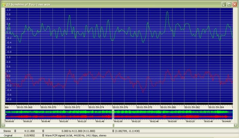

zoom into the maximum peak for the left track (top) - note there is some head room
