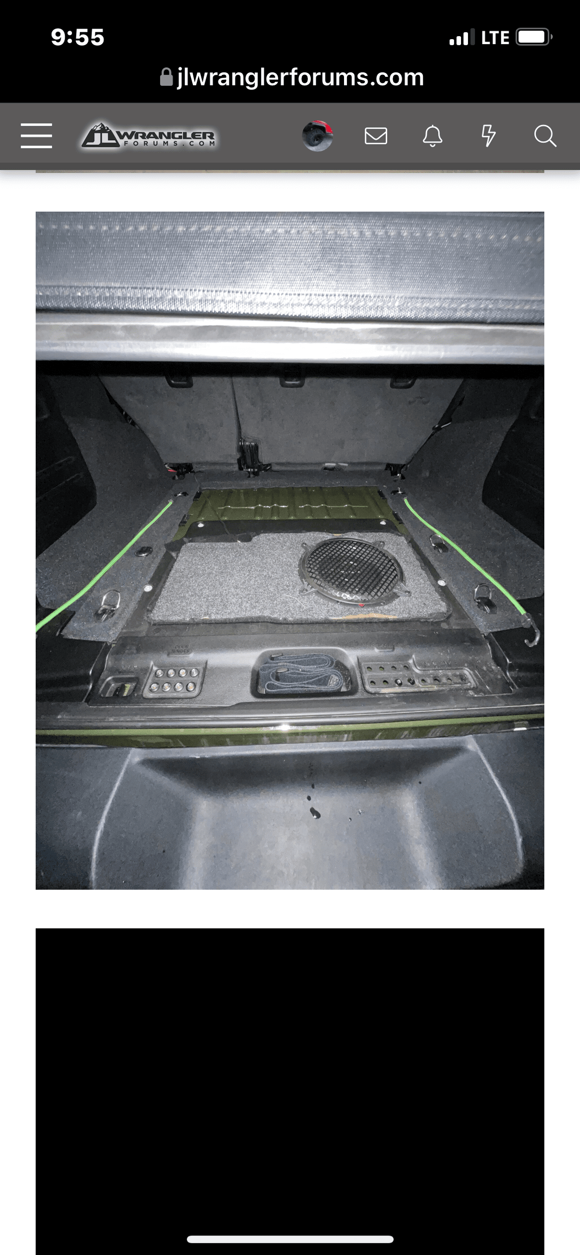

I currently have a large ported enclosure with a FI “Q” 12 powered by a teramps 3500hd.
I am considering selling the FI and enclosure, in order to free up some cargo space. A fellow Jeep owner has a custom built fiberglass enclosure that goes under the rear cargo mat. Here are the specs:
cutout - 10”
Total volune
Cubic feet is a .96 cu ft
(25.5” x 13” x 5”)
Mounting depth - 5-5.25”
Do any of you know of a 10” sub with a short enough depth that will loud? Or anywhere close to the12”Q I have in the ported enclosure?
You're going from a respectable ported 12 with a lot of power and space to a confined sealed 10 with depth restrictions.
I'd listen to the other guys before you make a decision. Or at least listen to a sealed 10. @Slo_Ride has a point
i had the Q in a smaller sealed enclosure years back and was not happy at all. Thanks for the input. Will stick with what I have

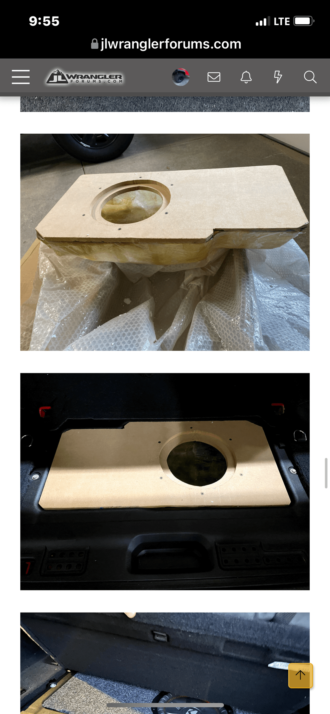

Can you add a port to the glass box? You are making a huge downgrade boxwise. You have to choose between space and bass.
i guess I could. I think one of the issues I saw was the mounting depth. I don’t know of any 10” subs with a mounting depth less than 5.5” that would get even in the same ballpark.
A shallow JL or DD would probably be your best choice. I don't see any way that it will be as loud as you want. Have you thought about a smaller enclosure with two nice 8's or four 6-½'s? You could even have a quick disconnect on the box if you ever need the cargo space.

Do you think the mounting hole can be opened to 12.5"? If yes, you can use a 13tw5 by JL Audio. It requires .80 cu. ft. sealed. You will definitely not be disappointed.

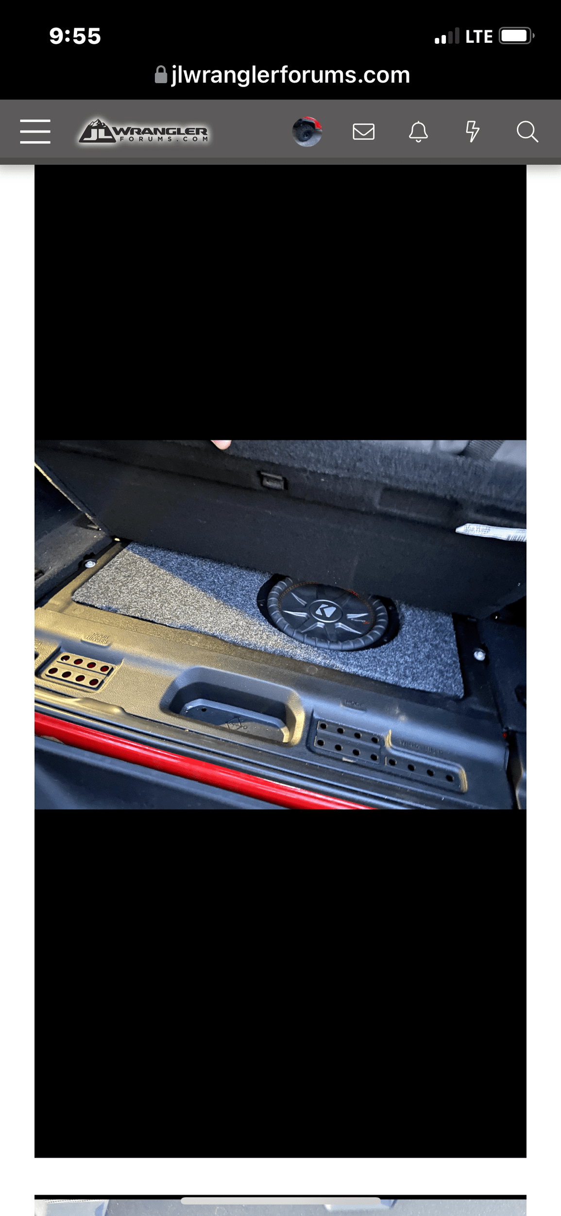

Neither had I. Saw these on Youtube flexing an F150 quite nicely. Got a pair and it was not a lie. The power is there but not just that; they get pretty low for shallow subs. Went to pickup the airless at a remodel project and left the radio on at low volume. The bass inside the house was as if there was a home theater playing in the middle of the house on blast. Maybe it was just the FS of the empty house, but it left me quite impressed.
On that note, I concur with Bobbytwonames. It will not go as deep or brutal as your current setup, but it is the best replacement if you must keep it compact (IMO).
cutout - 10”
Total volune
(25.5” x 13” x 5”)
For what it's worth, I ran a shallow 10 under the center console of my pickup for about a year. it was a JL in a custom fiber enclosure. pretty spendy. It sounded good, better than stock no doubt, blended with the music, but it didn't make me feel the way bass should. It didn't make me smile. It didn't feed my soul. I finally put a 12 in a ported box on 1500 watts and sacrified a back seat. I told myself i could take it out if i need space. I'm not taking it out. I need it. lol
