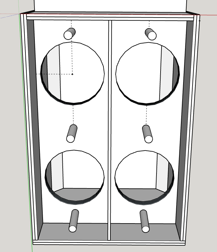

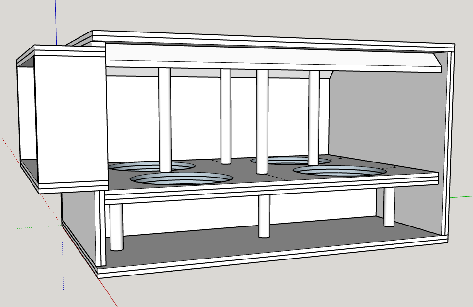

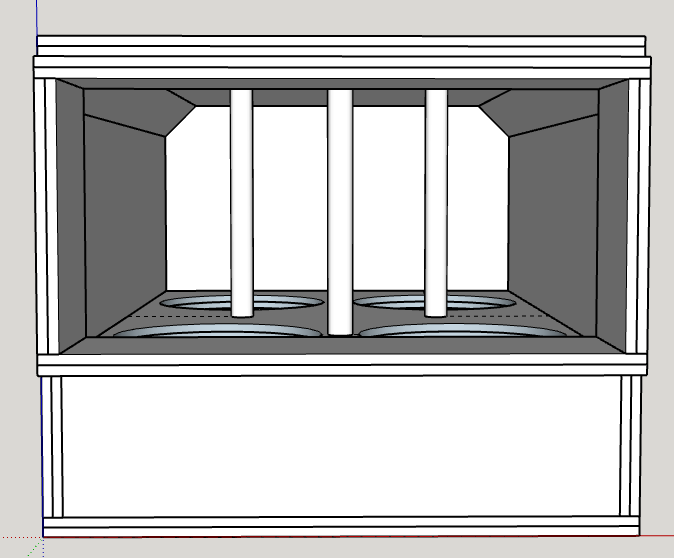

Ive been doing lots of studying and practicing with my enclosure designs recently. I just finished this 4th order for a guy down in Alaska! We met on Instagram and after a lot of back and forth we finally have a completed design.
The box is a 2 to 1 4th order tuned to 55 hz for 4 SKAR EVL 18s. Sealed side volume is roughly 13 cubes and the vented is 26. Port is 17.6"x 36.4"
The guy is going for maximum SPL hence the higher ratio and tuning. Give me you're honest thoughts.
Thanks

You're entitled to your opinion. I don't take anything personal. Not everyone is like me though. A lot of people leave the scene after getting shut down online. Its guys like you who are killing the car audio community.
I like how he says, "Help" after he just ripped you on the selection of the subs. You asked for thoughts on the box, not the subs. I have noticed two subjects that trigger pretty much everybody on here, Skar and Down 4 Sound. Gets em' every time.
you may like them facing forward rather than Rear faced. Its all about how you like and enjoy by your ear/listening not others. try Both...

is this a ported enclosure or a 4th order? If 4th and tuned to 33hz, unless specifically designed to do that, it wont have any bandwidth. It might...
