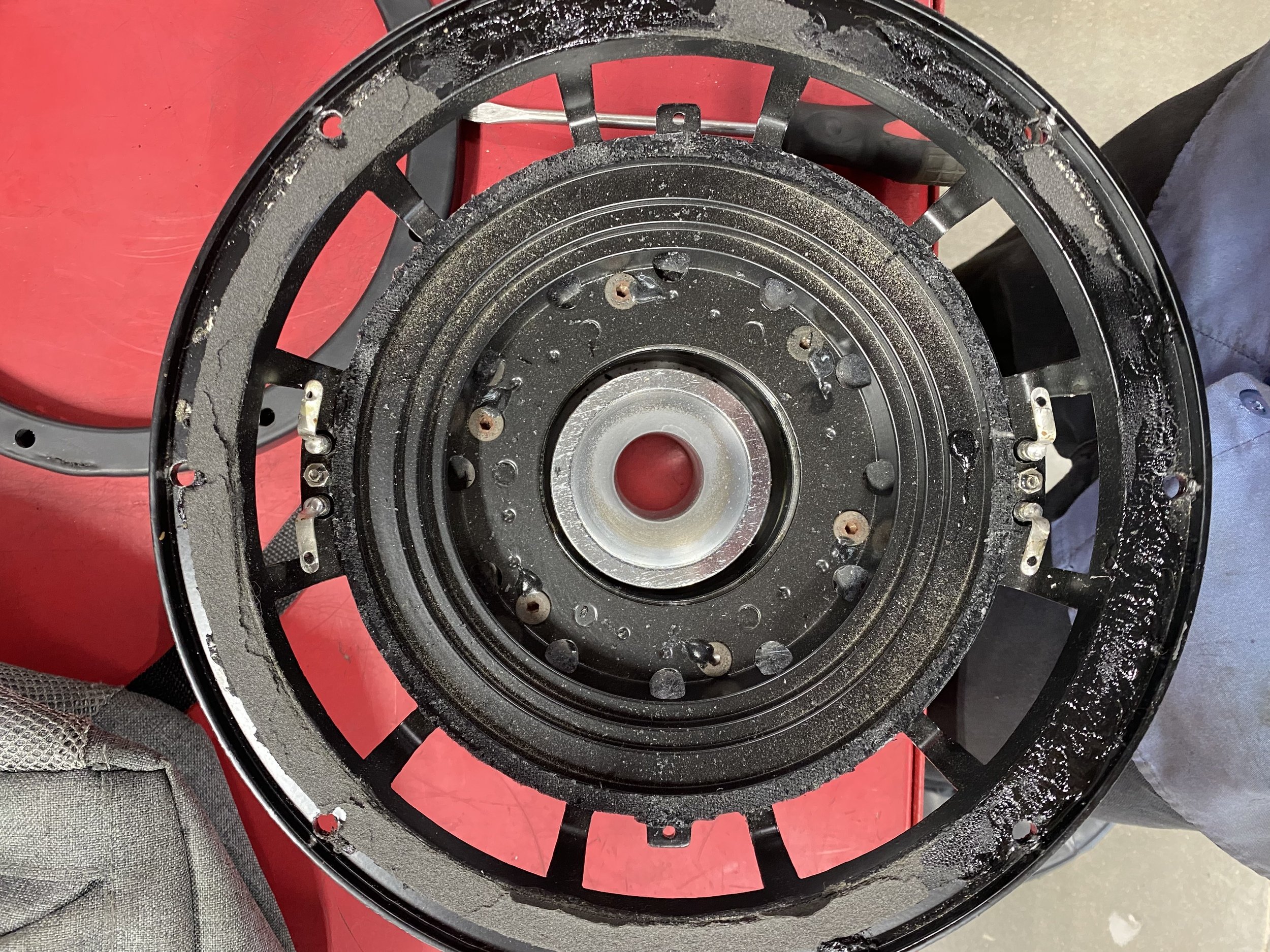

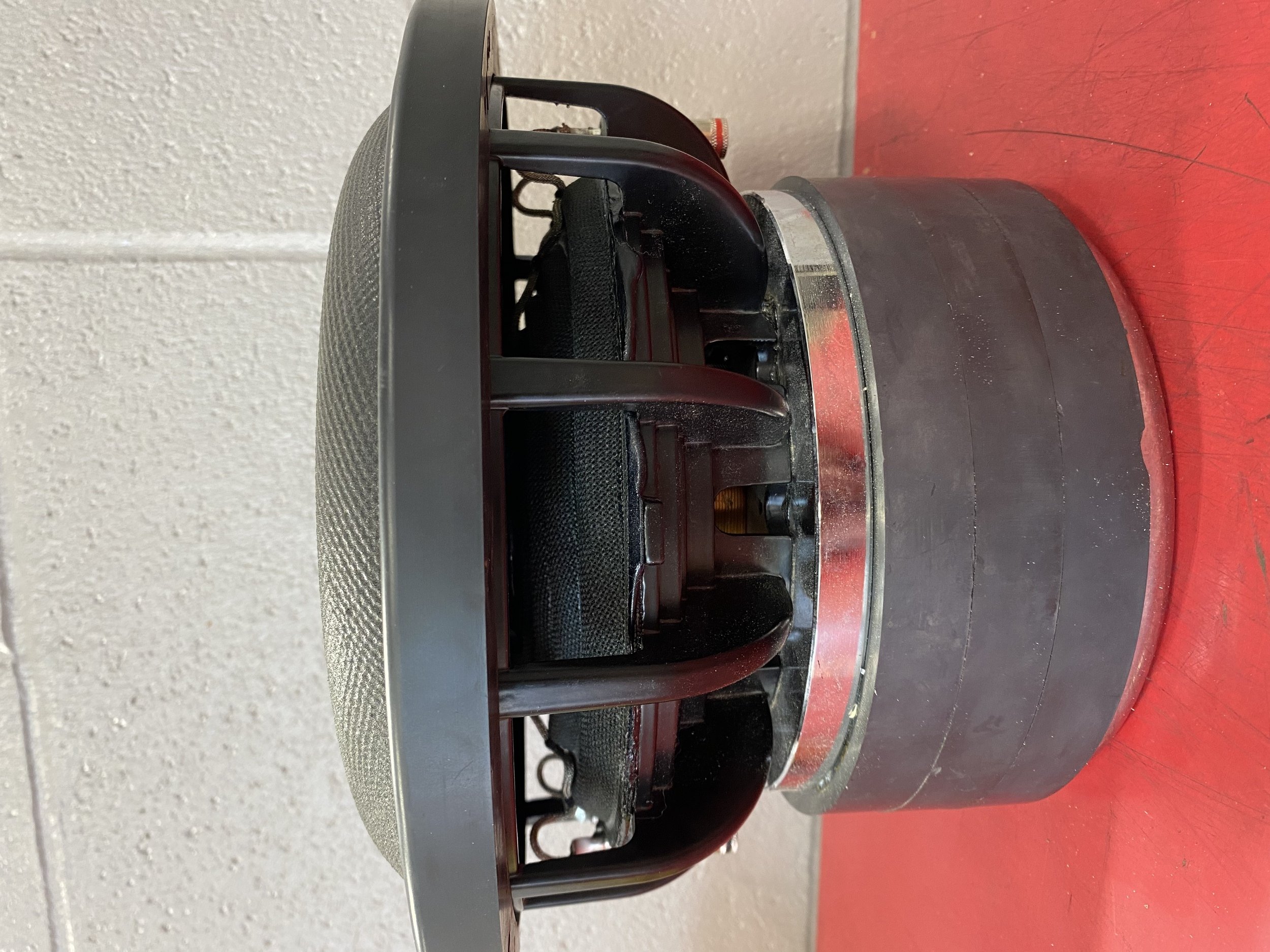

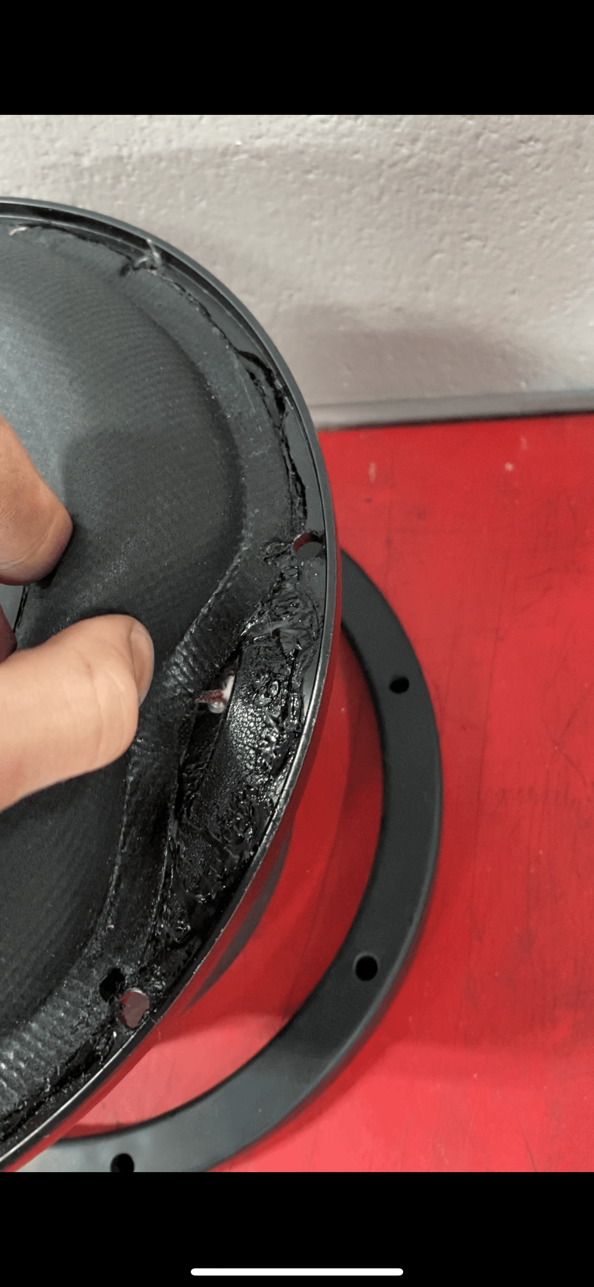

Recently sold an old sub of mine and a couple days after install, this happened. Any guess as to what caused it? He had it on an Audio Legion 1600.1 and in an aero ported box around 1.3 cubes I believe. It’s a DC Audio Level 4 10.

Looks like the coil jumped the gap and didn't reseat properly judging by the bump in the spider.
Someone was a little overzealous with the power.
Edit: DC recommends 1cf, so an extra 30% of volume would contribute to unloading before reaching the thermal limit, supporting the coil jumping the gap theory.
