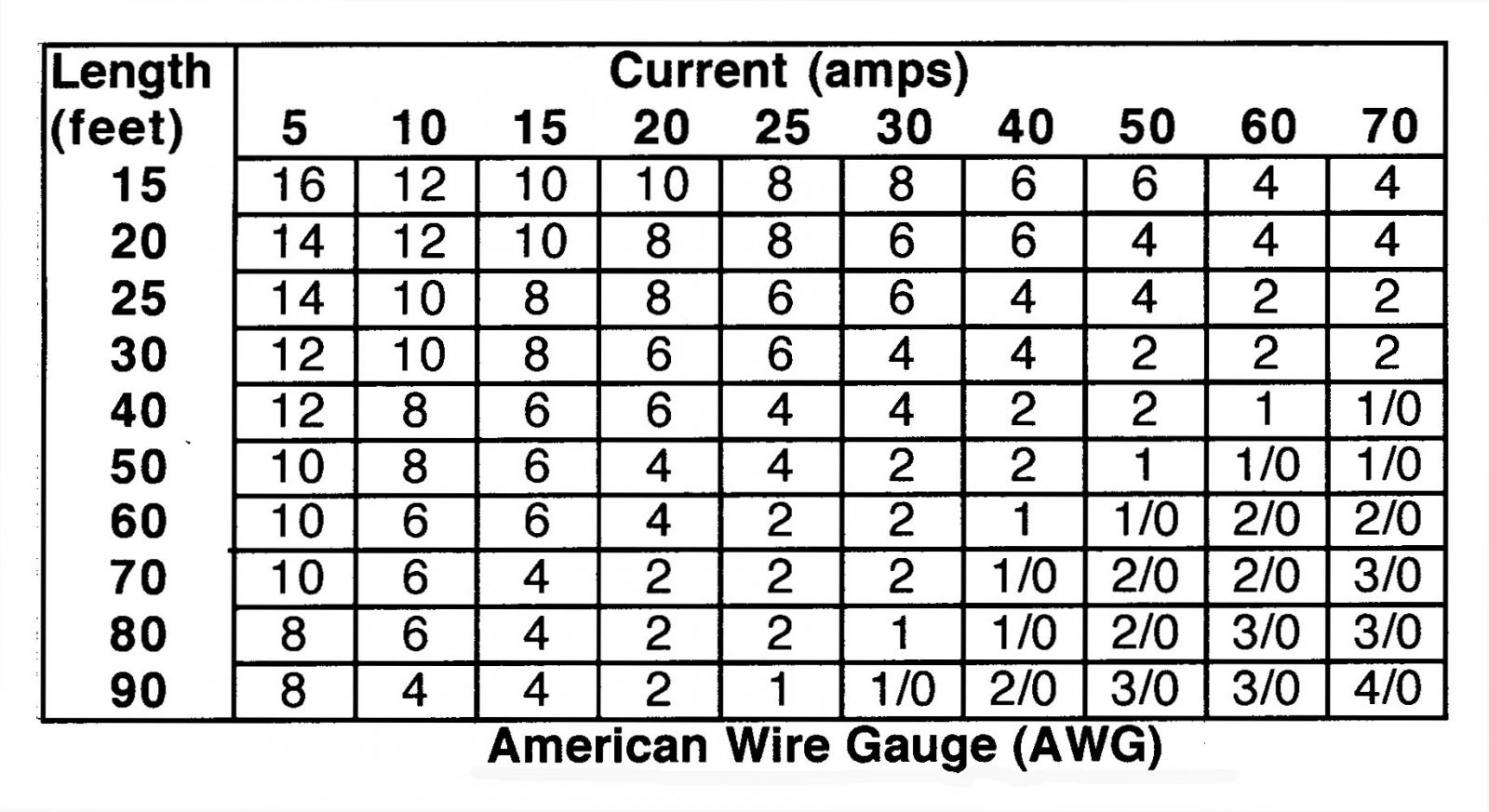

Wire gauge will be based on total current draw and length of run from battery.

Charts like this all over the internet:
