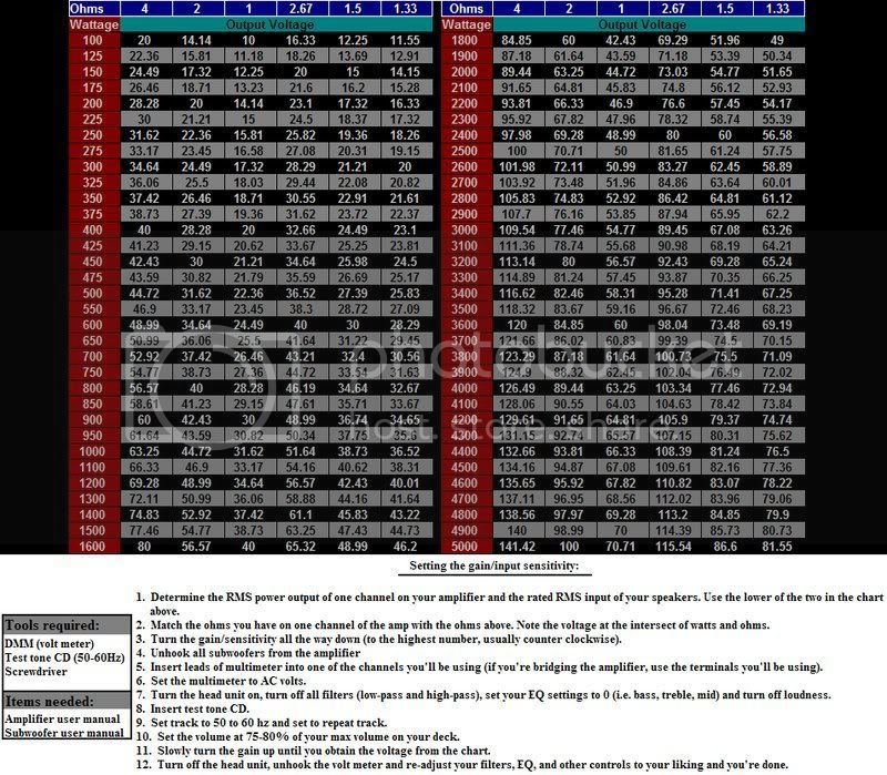

well, i found this. but i dont know how to do it with out the disk
you can download a 0dB 50hz test tone from realmofexcursion.com
You have an ac volt meter/dmm?
Ignore quin's bigger amp comment. Going over rated power by 10-20% makes very little difference in the output of the subs, but it does increase the heat in the voice coils and your odds of damaging them.
