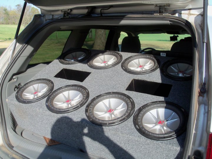

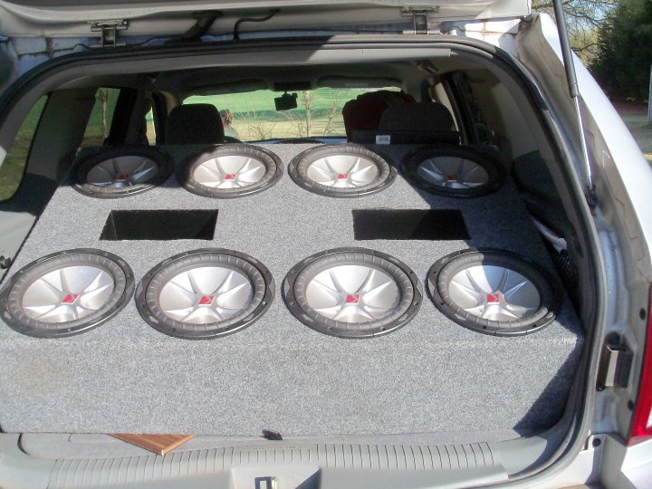

Ok cool, I'll keep that in mind. I just use the suv for hauling my toys, dogs, or anything else I can't fit into the cars, so budget is up my alley. Also, in the jeep, the box had to lay down at an angle, and the sound waves would bounce off of the back glass and roll forward. In the new suv, it's cargo area is big enough for the box to stand up, so I believe the sound waves are traveling lower, and getting caught up at the back seat? Maybe that's why they didn't get around the 153 range this time? Here are some pix:
New set up:
It's something to keep in mind, but also to take with a grain of salt. That was in a case of extreme SPL purposes, and was more than likely, in no way, musical. When it comes to score chasing, the one word you have to remember is testing.
you should try laying the box all the way down like a 'no wall' setup. it could be louder. or maybe not...
Yeah, I forgot all about the extra room lol. And you're right, different angles, and box positions matter when going for louder sound or higher readings. How do you feel about them facing forward towards driver? Common or not so much?
---------- Post added at 01:23 PM ---------- Previous post was at 01:22 PM ----------
Agreed! Very wise words!
I think you would need to create a complete baffle for the front if you wanted to fire it forward, so it would be more like a real wall. Also, subs up, port(s) back would probably be louder than your current subs/ports up situation. four 6" aeroports rear firing in a new box with those same woofers could be cheaper than a whole new equipment/build and yield better #'s.
Yeah either fire forward, or lay that down or push it forward, or push it 3/4 of the way closer to the back of the vehicle, let it load of the hatch some.. Any of those 3 will be louder than what you have I'd bet.. Even if it somehow meters less (**** happens) I'd bet to the ear they will be louder.
Man I wish I had the specs on that box. The guy who built it was out of Georgia, and has passed away. He was older, but really knew his stuff. I wish I could show the internal port(s) design. The box was made smaller, because it was going to be a tight fit in the Jeep, but with the Caddy, I could put two of those boxes back there, lol
