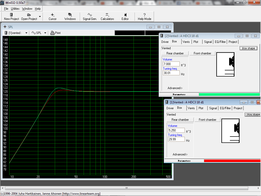

And to Jeff just making your box bigger won't make the lows better. The vehicle and port and shape of box have a part in it too. My box is 29 cubes tuned to 30hz and my low end is weak but my 39-32hz is 155-157db on music

You wont reach lower but you do have a much more powerful pronounced peak at the lower end of the spectrum.
I don't like computer programs. I like trail&error because everything is different inside a vehicle
It can start you off at the right path in the beginning cabin gain will change a lot but the response is still similar as projected but smoothed out a bit if you know how to tune it around your vehicle's peak frequency.
I dont like wasting money on wood and time on error experiments, it minimalizes that by a lot.
