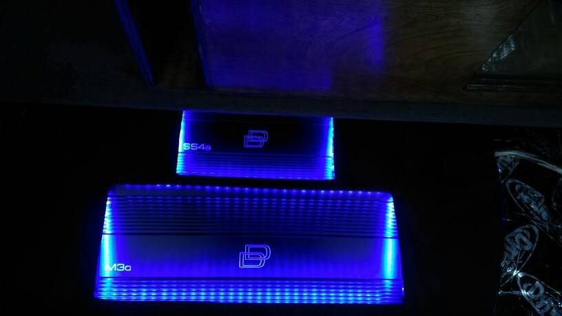

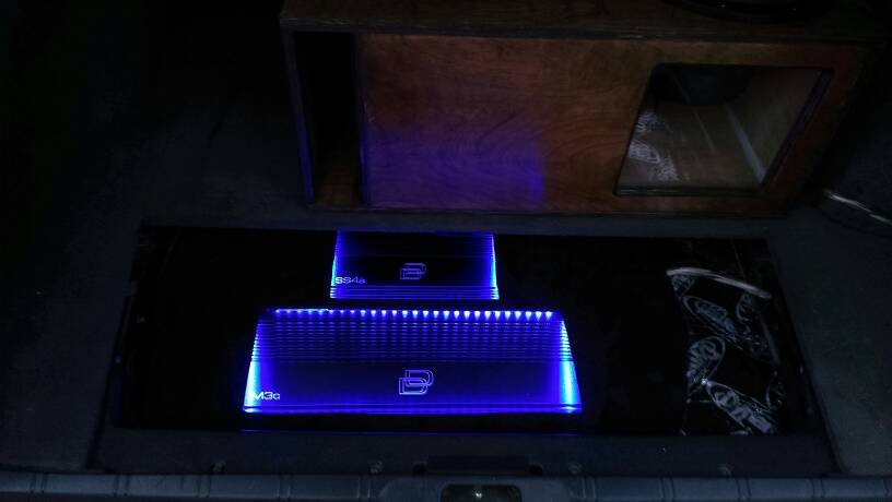

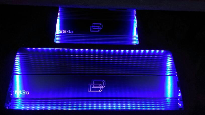

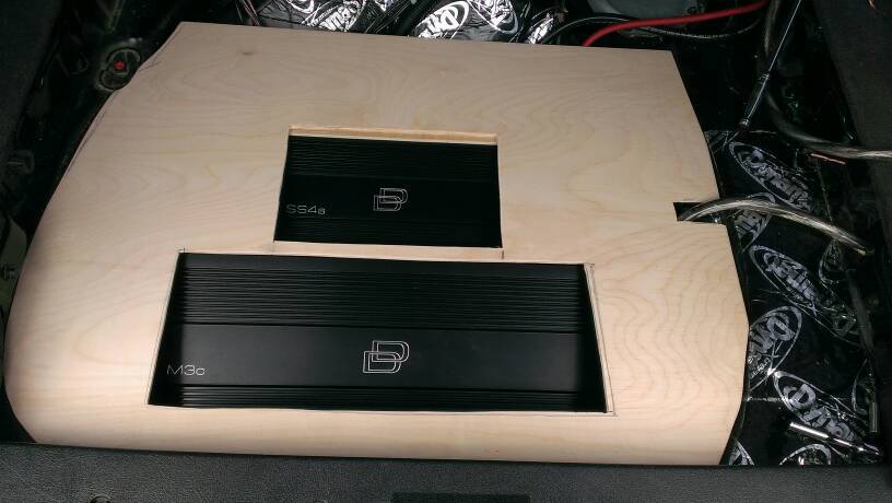

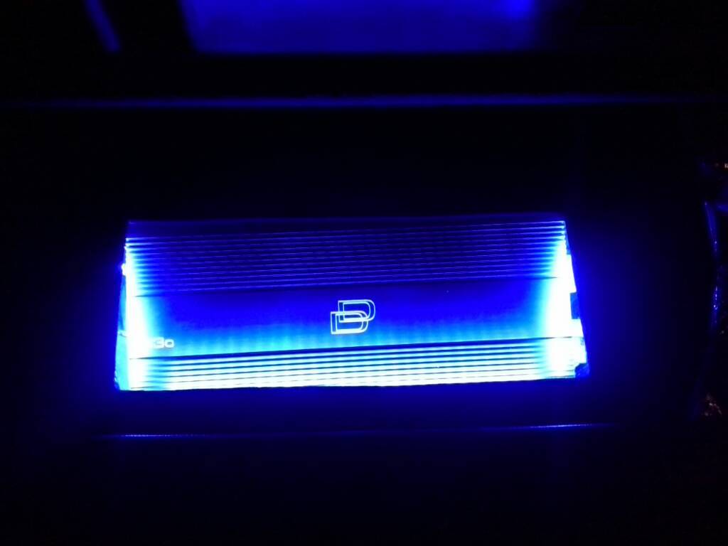

One thing I wanted to mention about this project is the cost. So far I've only spent about $30 for the suede and 1/4" ply. I used some spare MDF I had around the garage and I also had the LEDs but that would've only added another $20($5 LEDs and $15 in MDF)
Anyway the point is, a fairly nice looking, functional setup can be made for pretty cheap. I'm actually going to remake this panel when the other amp comes. This was just to make sure I like the concept. I free handed this one but I'll make sure the final one is done as close to perfect as I can get it.
Here is a night shot
Sent from my GT-N5110 using Tapatalk

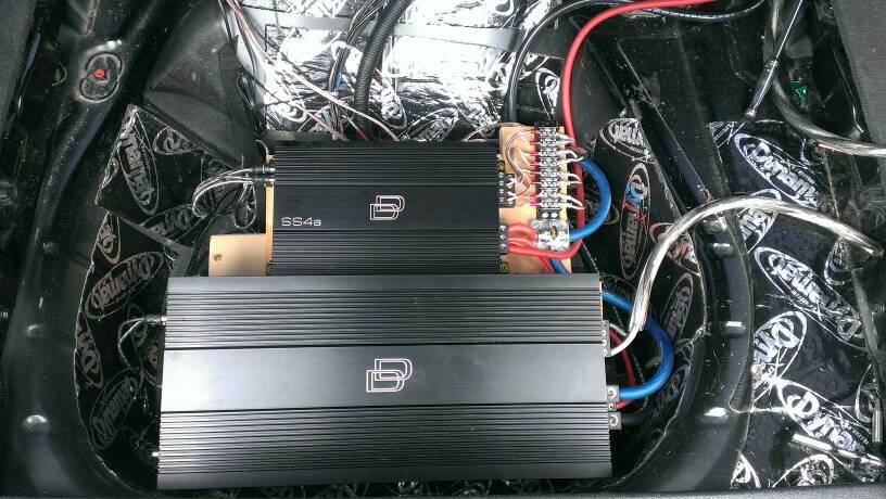

Got my ss4a the other day and went to work getting it installed. Going to get it covered a little later today then I'll add the lights.
Sent from my HTC6435LVW using Tapatalk

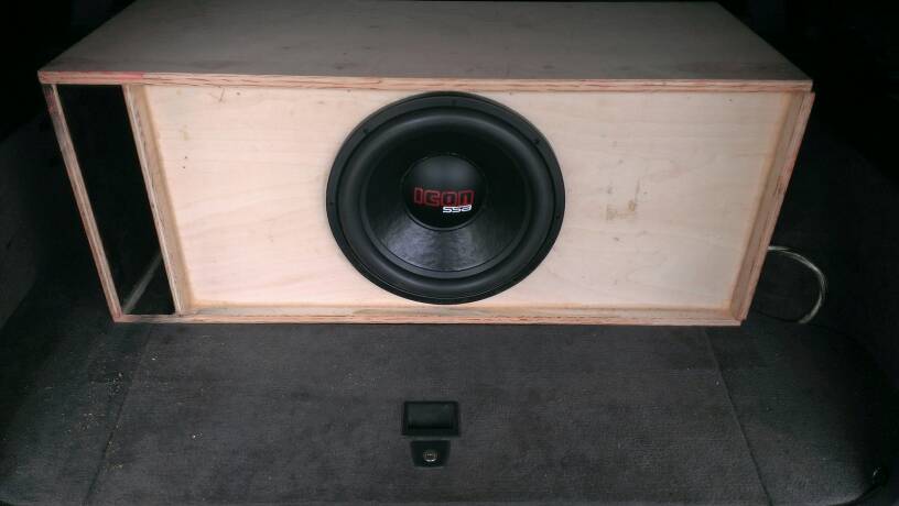

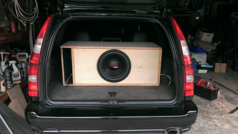

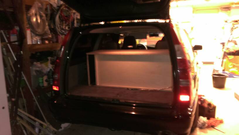

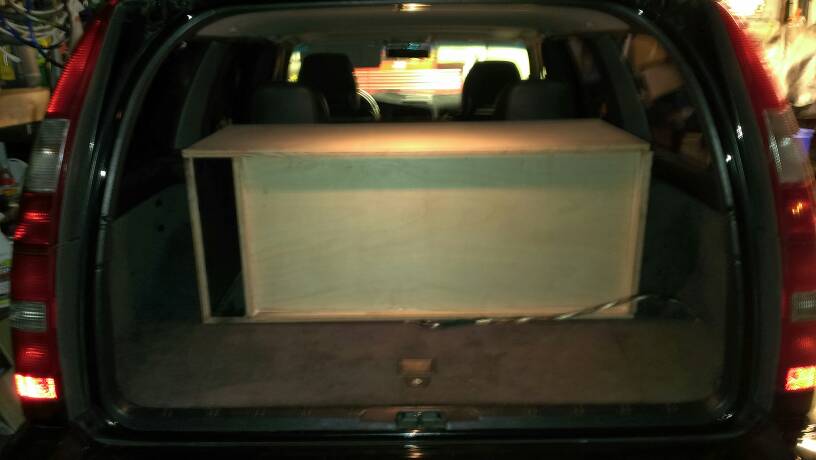

Finally going to put some of the space I have to good use. Built a new box today for a ssa 15" icon. It's not done, I need to cut the hole for the sub and add a terminal cup.
I have work tomorrow but hope to get it bumpin by Sunday. Box is 4.4 net tuned to 30.5hz.

That's a lot of power & a big box for an icon.
Lol yeah, the power isn't being used, I just got tired of buying amps everytime I get new subs.
I adjust the gain to match the power the sub wants. It will never see close to the full power of the amp. Also I'll be wired at 2ohm. The specs on my box are very close to the "optimal" box plans you can download from ssa. I put their box into the program then changed it to fit my dimensions while trying to keep the tuning and dislacement similar.
You should see the look on peoples faces when I tell them I'm powering a single w6v3 with the DD m3c lol.

One thing I did want to mention is the box has a 1" lip all the way around on the face of it. My plan is to make a removable grill using a wood frame and speaker grill cloth. I'm shooting for a press fit but I'll probably add magnets to ensure it doesn't pop off when I don't want it to.

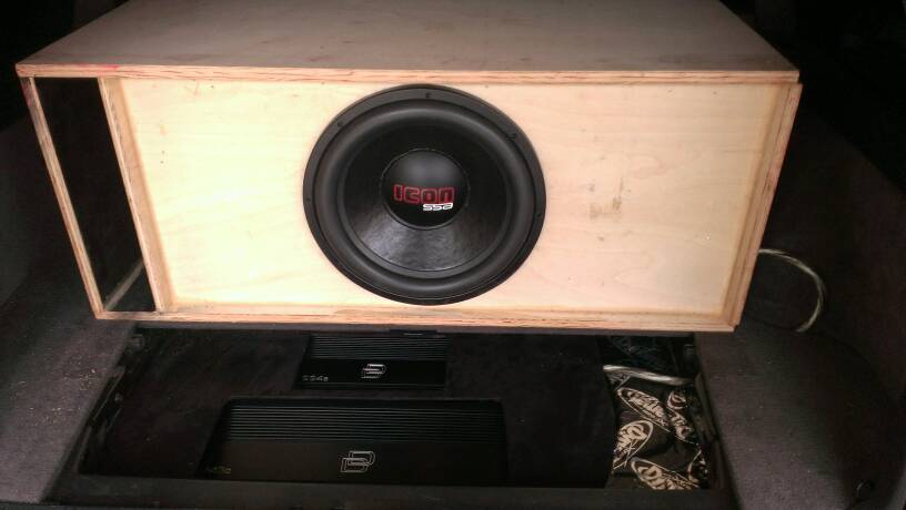

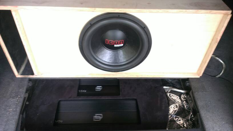

Some pictures of the new box with the sub installed, as well as with the amp rack visible.
I keep the floor panel locked up so the amps are only accessible by key.
