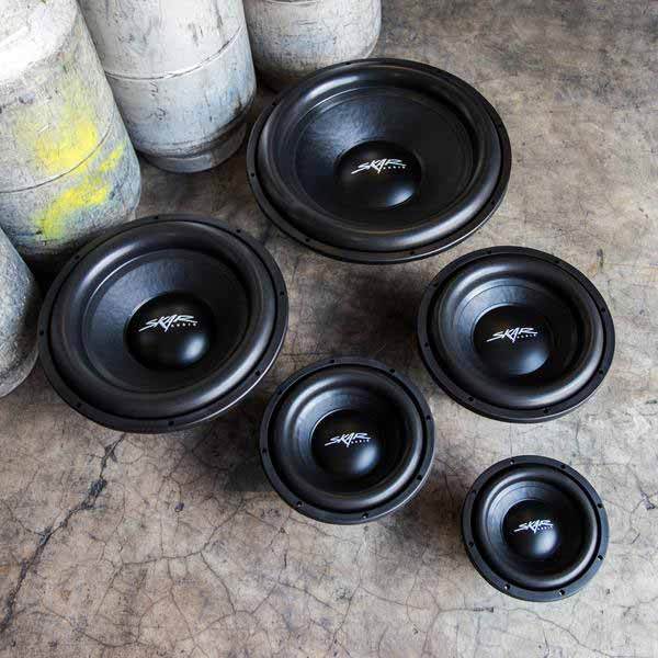

My friend has this sub and needs a box. They recommend a tiny box, why is that? Do you guys think thats a good idea? Most boxes for 18's are in 6 to 8 cube boxes correct?
Recommended Ported Volume: 4.60 ft³

Skar SDR?.. probably since it has a tiny relatively weak motor for the size of speaker.
I wouldn't expect big strong lows like quality 18's but a punchy and strong response in the 40hz range instead.
That tiny motor probably is suited better for the 10" or 12"...With a 1200 watt amp @ 1 ohm I would personally go no bigger than 5.5ft3 net and I feel a single 6" aeroport should be sufficent tuned to 32hz if the subsonic is set about 3hz under tuning.
I usually hate the Skar enclosure recommendations but in this case it's probably for a reason.
