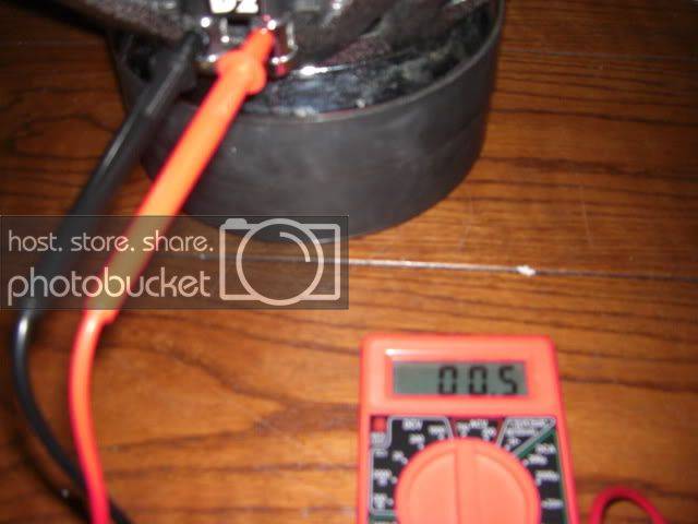

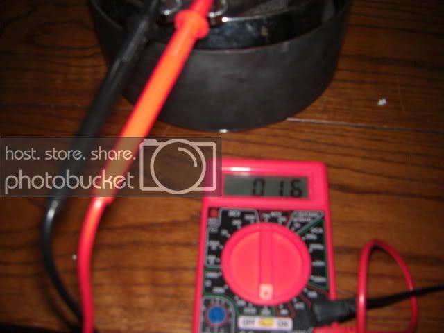

I just got my hands on D2 IDMAX. One of the coils reads fine, however the other one reads between 1-0.5. How screwed am I?
does ID have an email addr I can email them to inquire about a recone? I can't find one on the site and its alot easier for me to email at work than get to a phone to make a call.
check the terminals where the tinsel is soldered on. i had a sub reading that was changing and the terminal wasnt crimped enough. i could wiggle it. just clamped it down harder, little solder, fixed.
I'll have to check that tomorrow cuz my friend isnt here anymore. I'm pretty sure the terminal was fixed right though. The reading would start around 40, then 16, then it'd be jumping around 4-5 and an occasional 16. It only happened on one voice coil.
