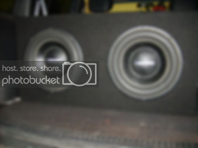

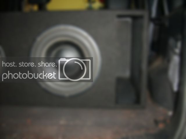

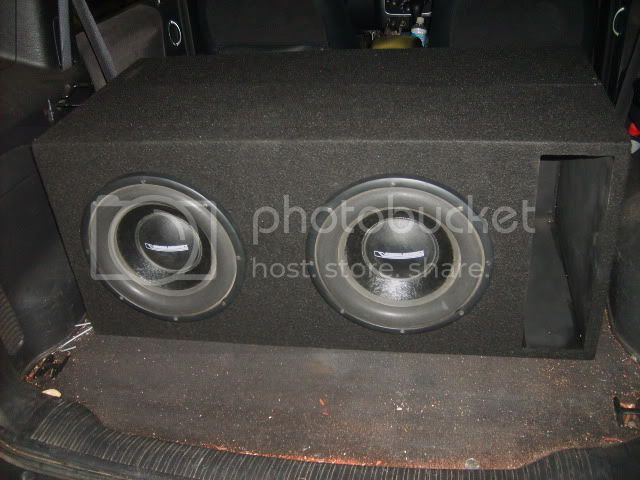

4 cubes (internal). tuned to 32 hz. Has 69.75 sq. inches of port area with a 4.25" wide port!
(2) 12" SI BM's
(1) MMats 800.1 (800w @ 1 ohm w/ 12v) (1300w @ 1 ohm w/ 14.4)
MMats 1100.1 on order!
Will be going on the Term-LAB tomorrow morning to see what kind of an increase we can squeeze out of it! For all you O.C.D nazis, I know the back of the Jeep is dirty, but we were remodeling the shop and it will be cleaned.
****, now that i look at it, the subs could use a good cleaning also. At least the shop is done and all the dust has settled.
BTW, everything might be going up for sale soon! We're debating stripping out the rear seats and going full wall in the Jeep, so if we do the subs, amp and box will be for sale!
4 cubes (of internal airspace) tuned to 32 hz. Has 69.75 sq. inches of port area with a 4.25" wide port. External dimensions are 39" wide, 17" height, and 19" deep.
