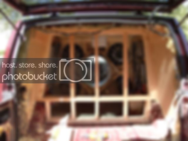

50 cubic feet, 20" diameter sonotube 18.5" long for a 23Hz tune. Wall is 10" thick, 5 layers of 3/4" MDF backed by a doubled up 2"x6" frame, 20 large tubes of PL PRO for the wall, 30 all together or more. 110 cans Great Stuff expanding foam. rear wall 2"x6" frame 1 layer 3/4" MDF.

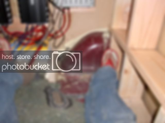

2"x6" rear frame
