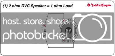

The sub just simply doesn't work. I have it wired like this...
to my Concept...

Tried swapping the RCAs with a different set... took the HU out to make sure the RCAs were plugged in correctly... took the sub out of the box and made sure all the wiring was correct and ran it outside of the box... Tested the voice coils on the sub, both are ~2 ohms each, so it's not blown by those standards....
