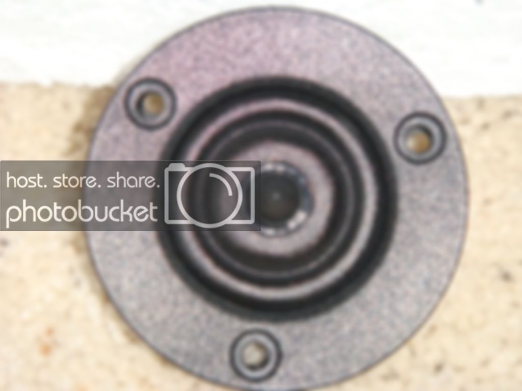

I hope it was these ones pictured. PE had two different buyouts with HDS mids. I guess the ones pictured can be called HDS 'Nomex':
