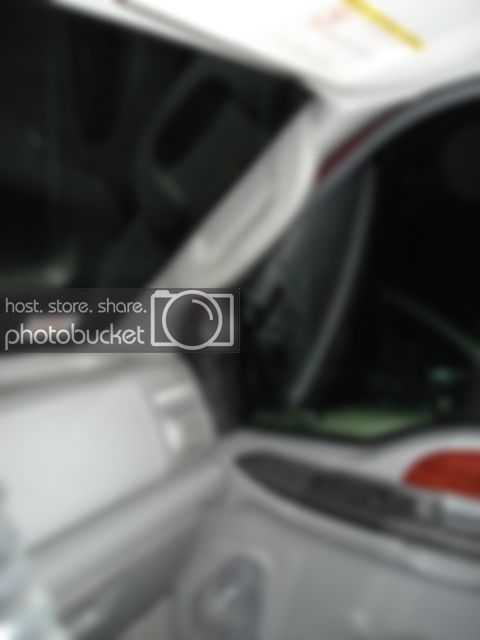

Essentially on axis means that the speaker is aimed at the listeners ears, while off axis is just the opposite obviously.
Here my tweeter is mounted roughly on axis, while the mid down in the door is off axis
