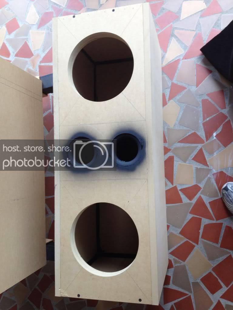

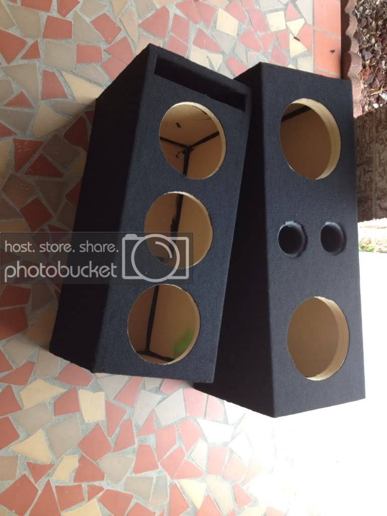

you can always us cooking oil. heat the cooking oil up and dip the amount of pvc you want flared in it and flare it out and let it cool. ive done it this way and it works good. my aero ports i have now are done this way
recess it about half way into the depth of the wood than use a nice size round over bit, do this to both ends. examples are 2 3" pvc ports:
