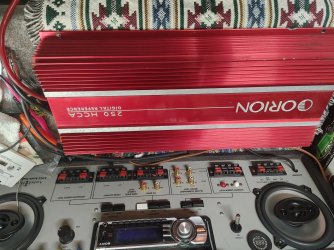

I have this to run car radios through ..the radio powers the two speakers ...and theres an internal car amp powering external speakers ..i can hook a radio to it ...or swao radios in it periodically ....it uses a coputer style powersupply ..ive reworked it quite a bit from original form ..it was made in the early 90s i believe ..it originally had 4" speakers ..i upgraded and modded holes for 51/4s for more mids when im playing it working on stuff....
