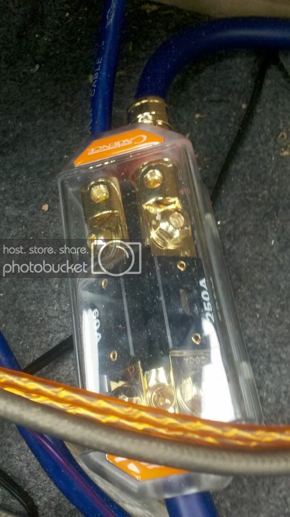

I currently run my car off 1/0 and 4 gauge, 1/0 for my sub amp and 4 gauge for my speaker amp. I do not have the Ideal setup as you would perfer to have a seperate power wire run of each size. For me it was cheaper, but more importanly for me easier to use one dual amp wiring kit that had 1/0 and 4 gauge. I run 1/0 from my battery to a fused distro block in the trunk. The distroblock takes the 1/0 input and has 2 4gauge outputs. Since splitting the 1/0 into 4gauge outputs completely defeats the idea of using 1/0 because in the end you are just using 4gauge to the sub amp and will lose power, my solution was go buy a reducer. A reducer is a metal slug that goes onto the 1/0 cable and has a 4gauge connection, so it saves the current flow of 1/0 cable but allows you to attach it to a 4gauge connection. So I have 1/0 from the batt to the distro block and on the other side of the distro block I have my 4gauge for my speaker amp, and have 1/0 for my sub amp hooked up to a reducer, not ideal but it is easy and works pretty well.
all in all your saying i can add another whole guage kit, or i can use a dist block? u say ur running 0 guage for ur sub and 4 for ur speakers???? i thought the dist turns into 2 4 guages??how thats that work
You know what I'll post a pic of my setup I think it will help you understand how you can wire it.
This is the fused distro block so the bottem is 1/0 in, the top left is 4gauge out and the top right is 1/0 out through the 1/0 to 4gauge reducer (gold metal part)

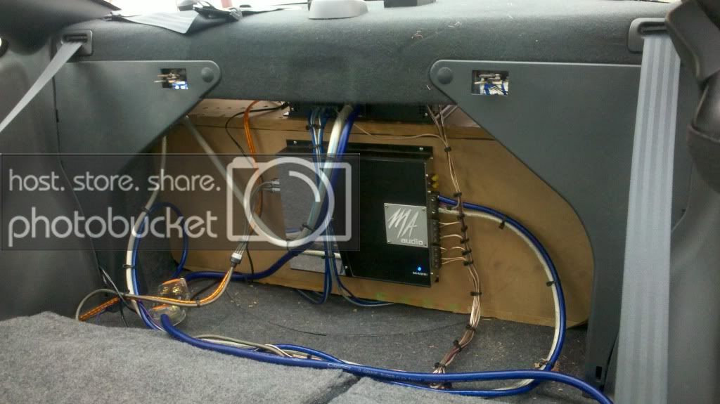

This is my old wiring job pretty messy but you can see where everything runs. If you look closely you can see the remote wire spliced into both amplifiers
C'mon man, clean that mess up //content.invisioncic.com/y282845/emoticons/smile.gif.1ebc41e1811405b213edfc4622c41e27.gif
