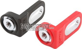

I'd do both, but i don't want my battery terminals to get overcrowded.
The ring terminals i'm using are hard to stack, and i'm already planning on grounding my amps directly to the battery.

If you are running out of room, pick up a set of these:
BUY ONLINE
