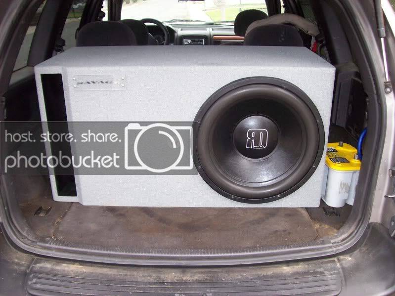

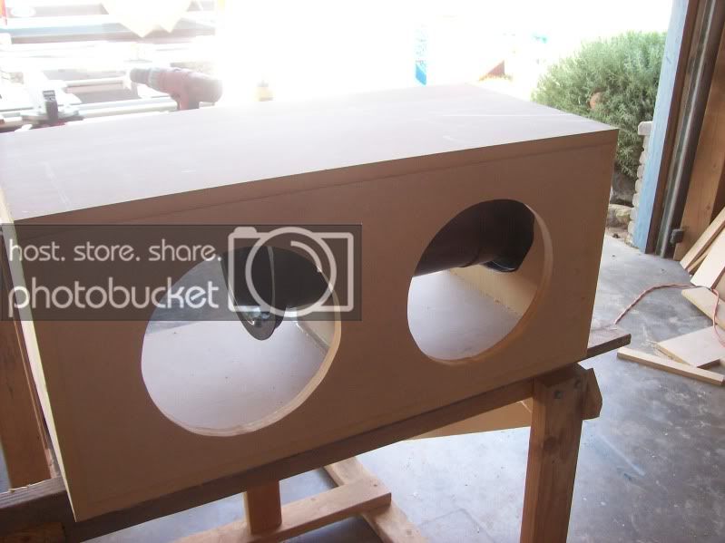

This is the cherokeez current setup . . RD Alpha 18" + 3250.1

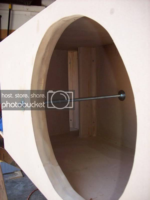

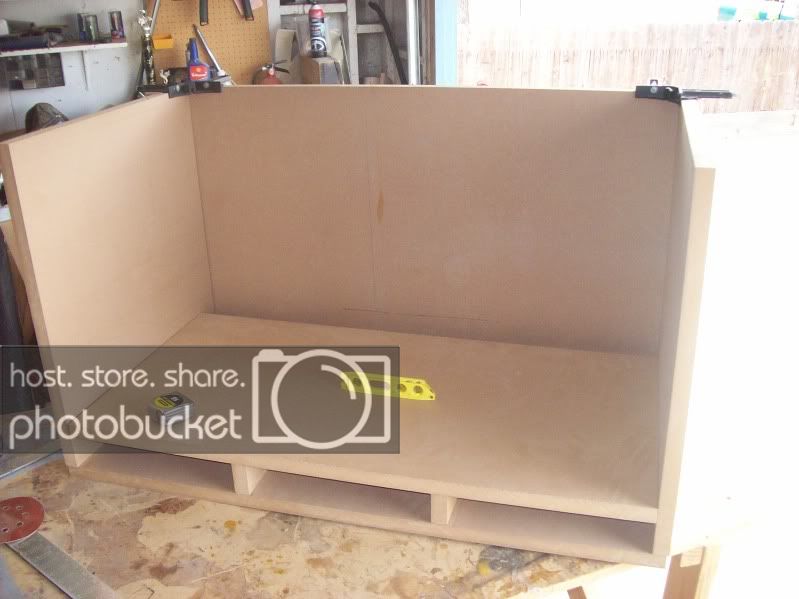

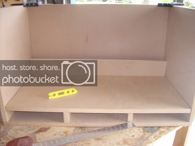

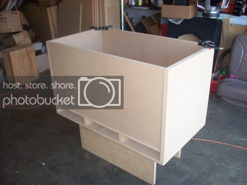

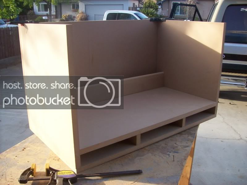

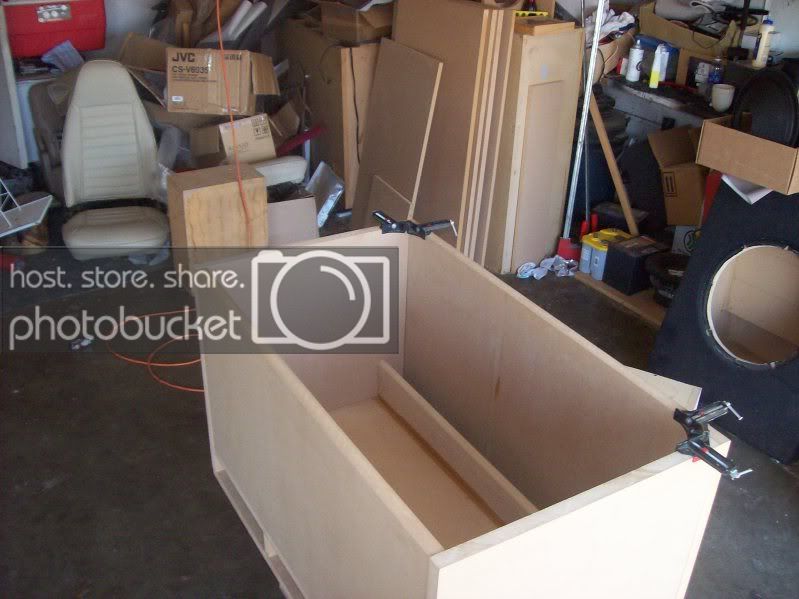

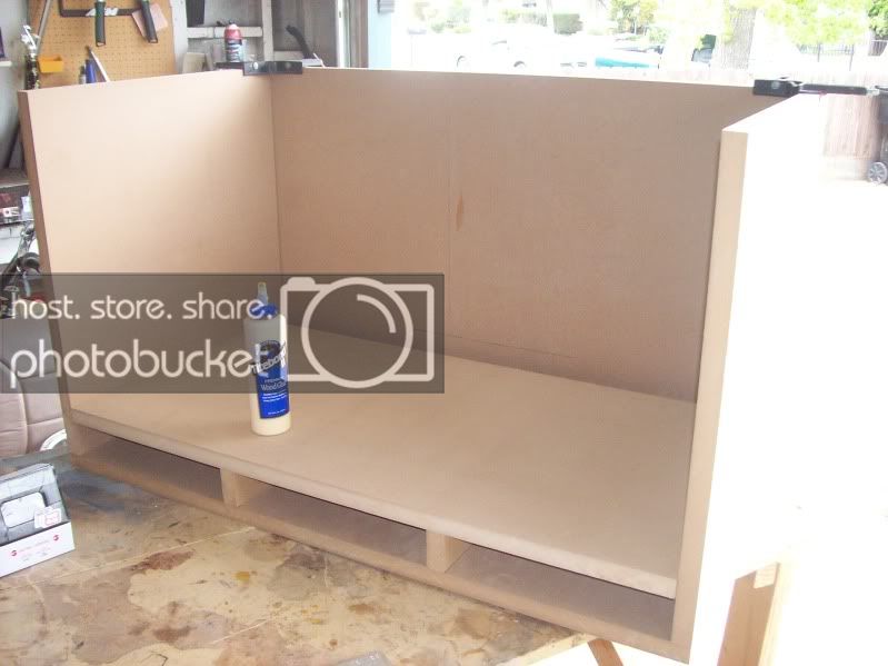

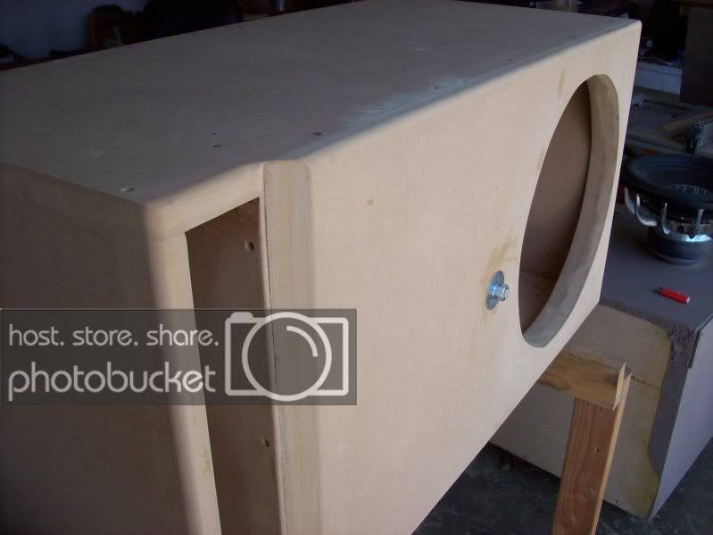

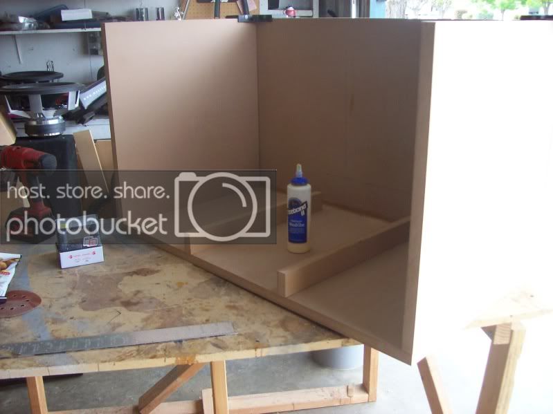

This is what we are working on :1" mdf 8.6 cuft before woofer displacement @ 30.2hz //content.invisioncic.com/y282845/emoticons/fro.gif.c695f1f814b01c4ad99fe7f8cccadd29.gif The 3250.1 will be @.4ohm and there are a total of 6 optima yellow tops , more pics soon

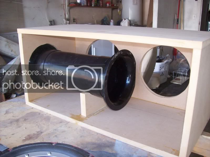

Bonus Pics ! !! this was for a friend his cousin gave him two P1 10's ! 150rms !(awesome!~) He has a Hifonics 1200 !lol . . came out nice 2.8cuft tuned to 38hz w/ 6" Flare ! (only listens to spainish)
