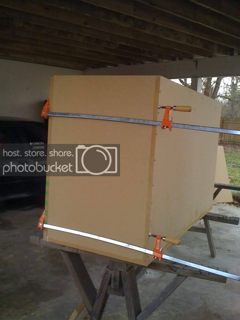

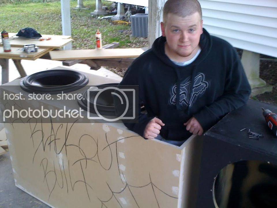

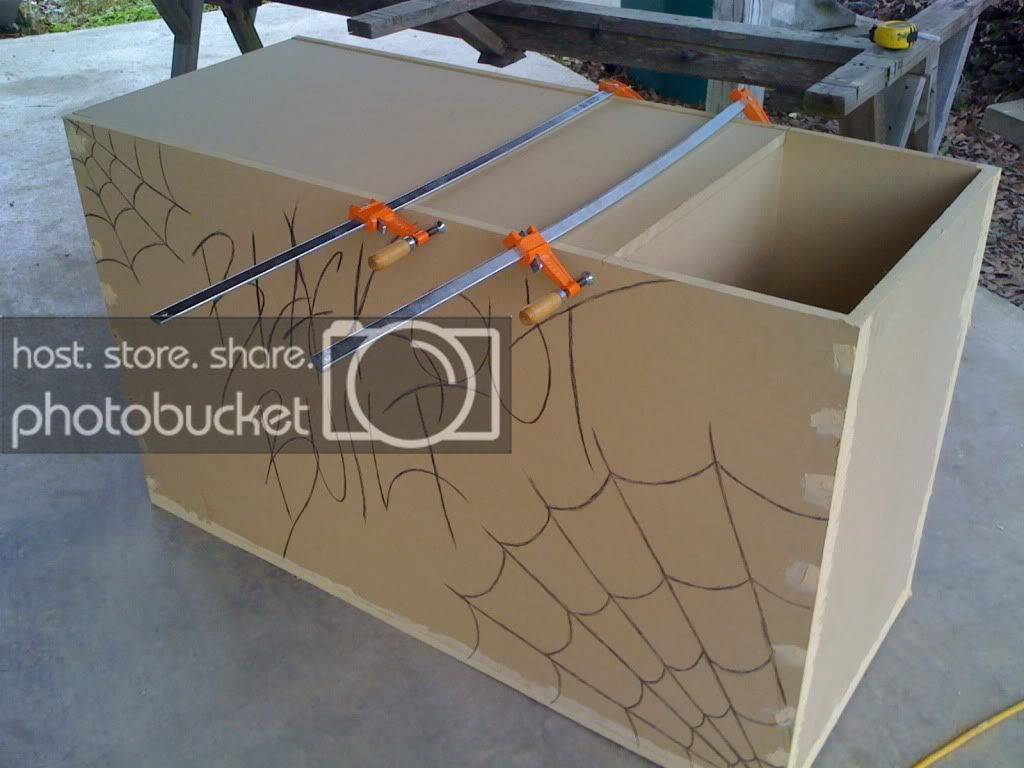

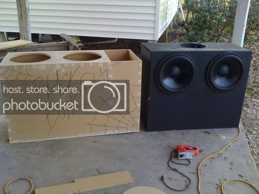

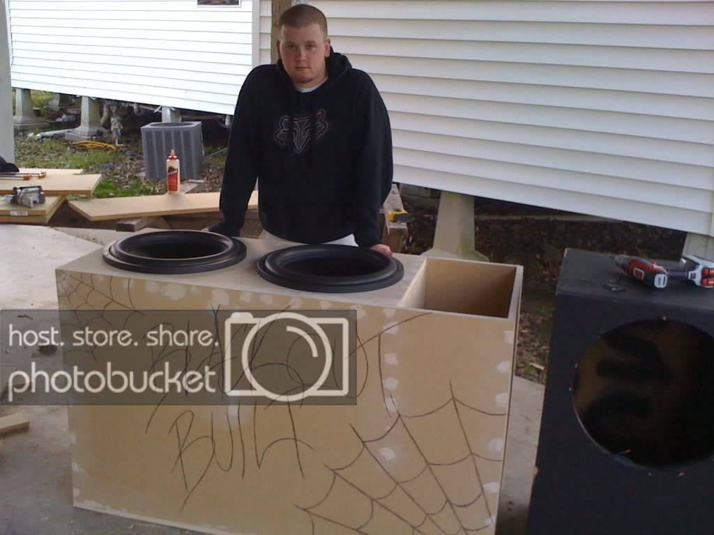

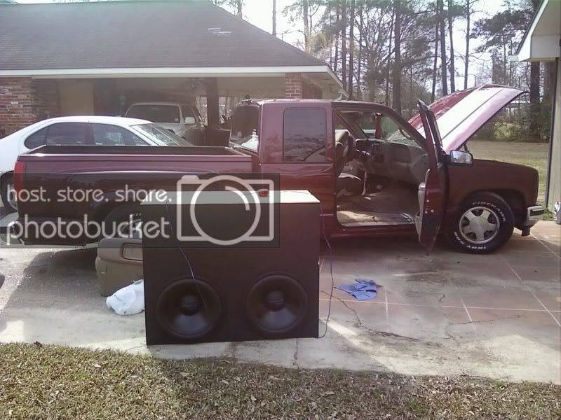

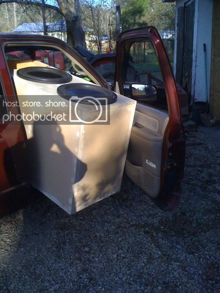

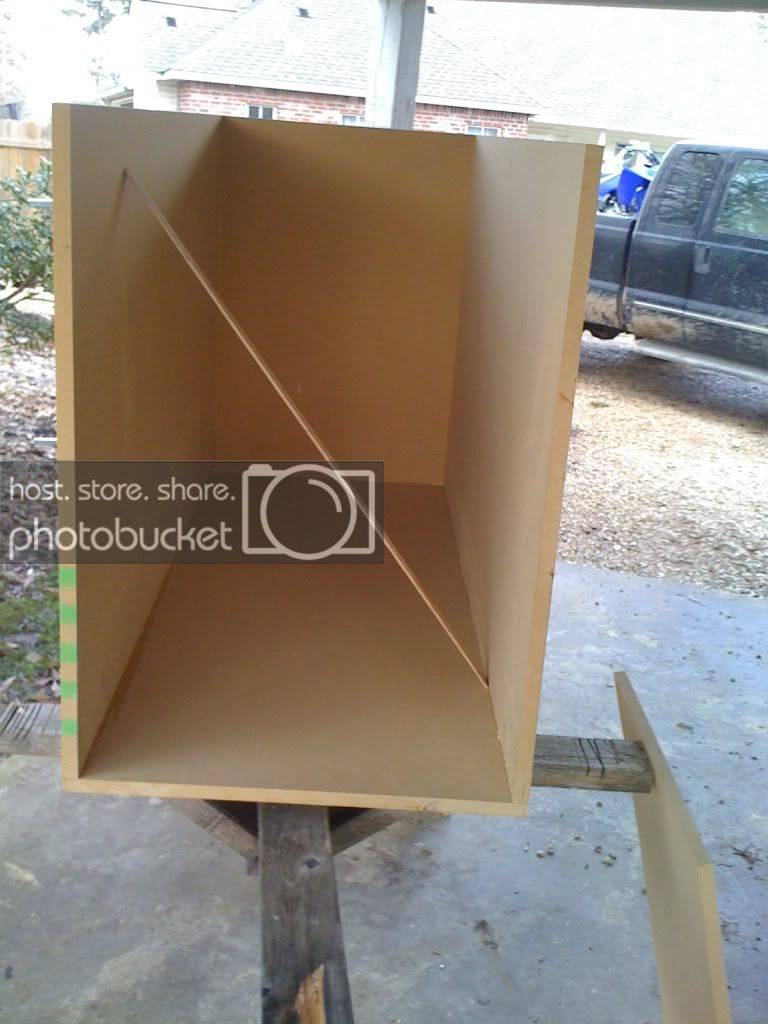

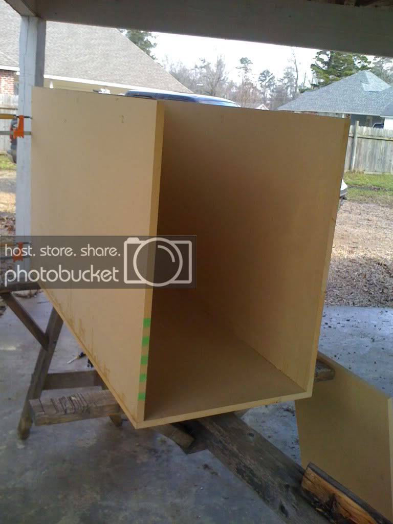

This is for Sierrawithdaslap on here, box is 14.7 cubes net with 258 sq in of port area tuned to 30 hz, its in a 97 Sierra extended cab. Its loud
Old box

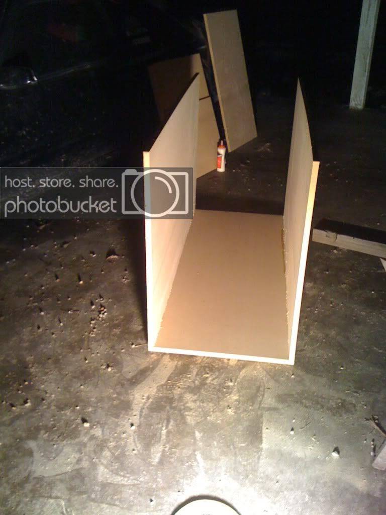

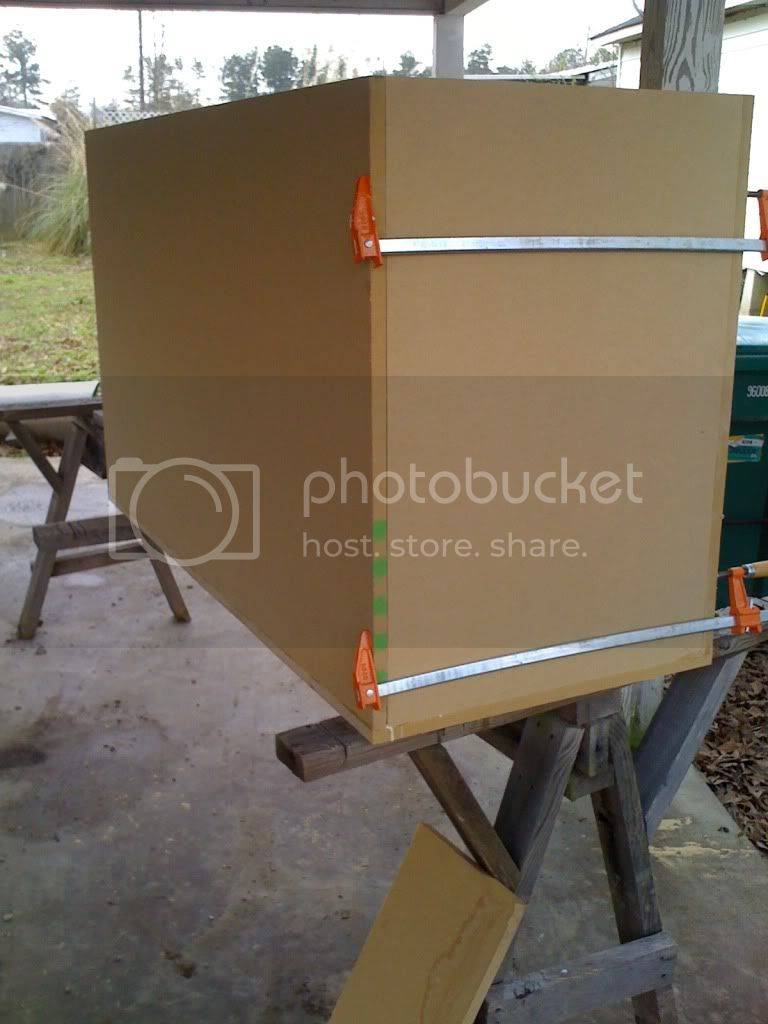

Starting the new box

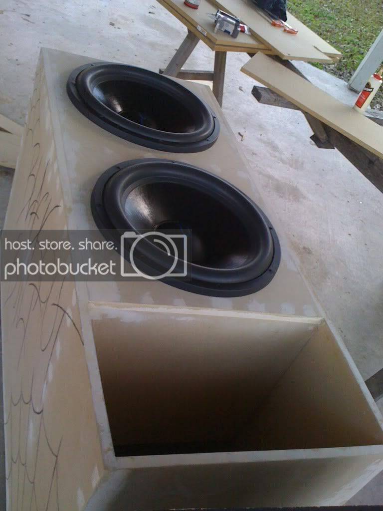

Yardstick in the box

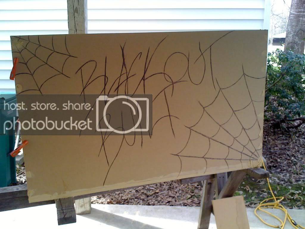

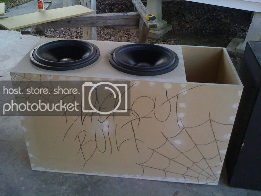

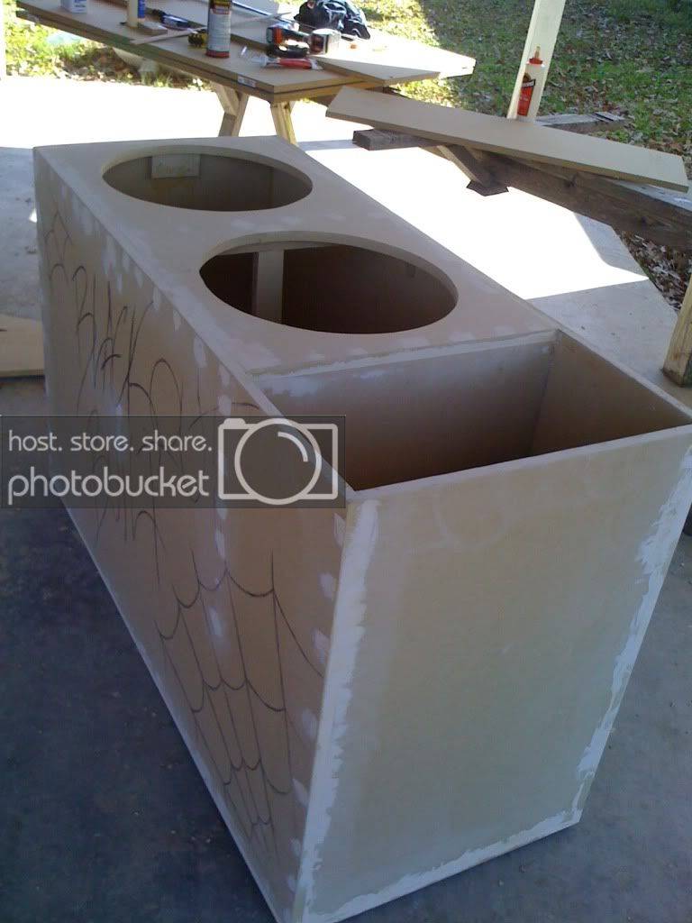

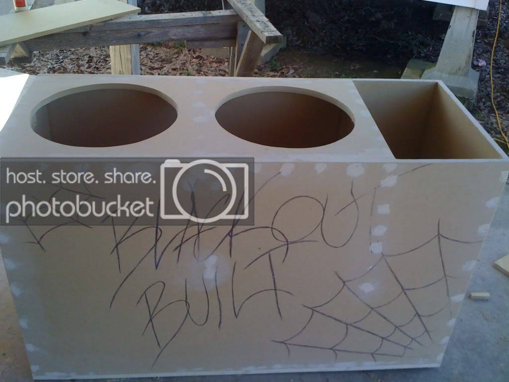

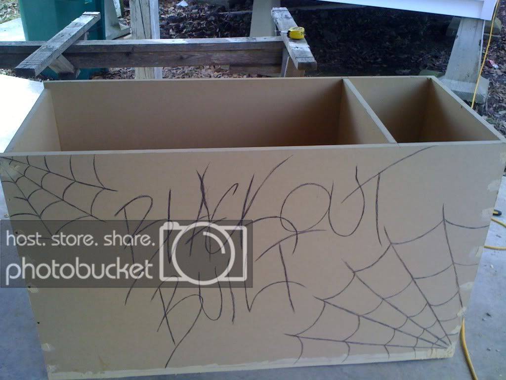

Did a little ink pen artwork while waiting for the drill batts to charge
Its called bracing fyi, it doesnt flex at all
With all do respect sir, that entire box will flex, you just can't see it. I had a 4" thick wall with 2 Solo X 18s flex on me. 3/4" rods added and I gained .8 db but that was strickly a competition build. If it's just a daily then you should be fine. Best of luck and enjoy.
I was figuratively speaking when i said it didnt flex at all. If you want to get technical, i would say every box built flexes, some in just minute proportions. And this is a daily box, so yes the very little it does flex is just fine
